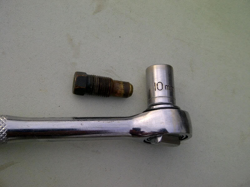

    Did a coolant change today and found the block drain plug/valve....attached a tube to it and it worked great!
    Found it between AC compressor and oil filter...right above engine mount....higher up on the block then you would think
    Pic of actual plug removed(no need to take out all the way to drain)
    seemed like brass...10 mil head

    When you pull the radiator plug on the 2.7 you get real close to 1 gal out, when you use the drain on the block you get about another 1/2 gal.
    After draining both you will still have some coolant in the system, which you can do a few cycles of distilled water to flush it out if you choose. Make sure to turn the heat on when flushing to get the old coolant out of the heater core and let the engine come up to temp so the t-stat opens.

    Yes, only one on the 2.7.
