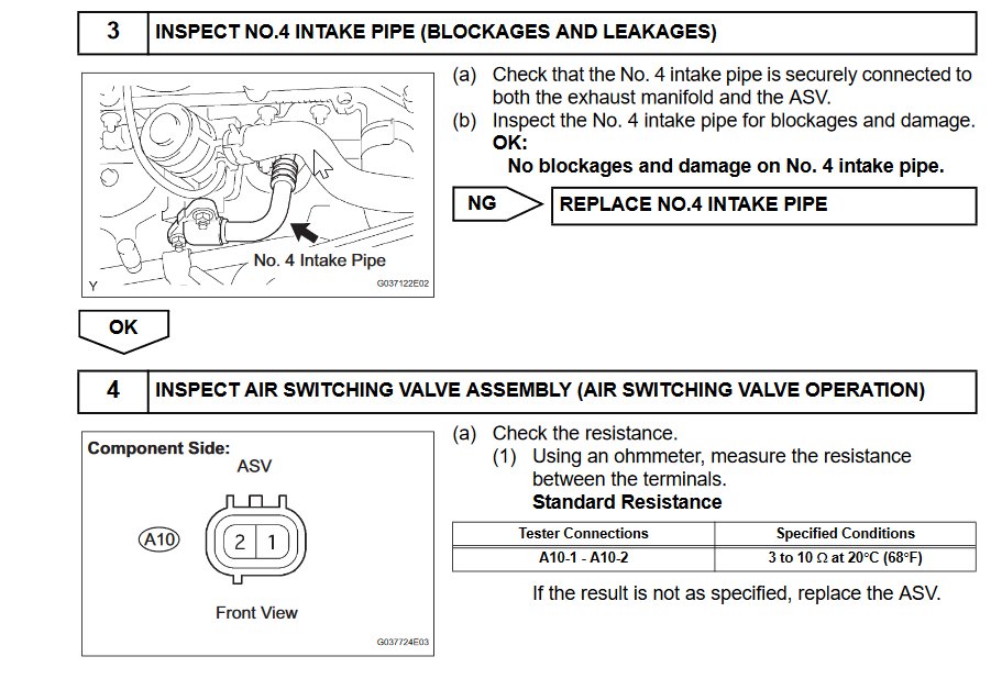

    Did you inspect the fat hose from the pump to the ASV?
    Check all wires and plugs for damage and make sure they are plugged in properly.
    Then you need to start checking the remaining items on the list in post # 21 and # 22:
    P2441 Causes:
    Pressure sensor detects no pulsation of exhaust gas despite ECM commanding Air Switching Valve (ASV) to open, while engine running (2 trip detection logic)
    •Open or short in ASV circuit
    •Vacuum hose (ASV - pressure sensor)
    •Air injection hose
    •Pressure sensor
    •Pressure sensor circuit
    •Air Injection Control Driver (AID)
    •ECM
    P2445 Causes:
    Secondary air pressure less than 2.5 kPa (19 mmHg) despite ECM commanding air pump to turn on (2 trip detection logic)
    •Open in air pump circuit
    •Air injection system piping
    •Vacuum hose (pressure sensor - air switching valve)
    •Pressure sensor
    •Open or short in pressure sensor circuit
    •ECM

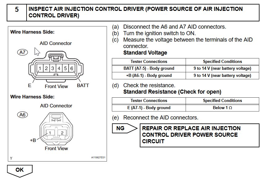

    OK don't be offended, but did you check the fuse for the Air Pump?
    50 ampere fuse in the engine compartment fuse panel, Labelled as 50A A/PMP. When you check the fuse use a mutimeter or a test light. Your eyes may betray you.
    This is what supplies power for the Air Injection Control Driver which powers the pump and ASV. If you don't have that it will never run the pump or open the ASV.
    SR-71A and b_r_o like this.

    In case you don't know where the driver is, it is behind the ABS Unit on the passenger side fender well area.
    The pressure sensor does cause codes. Did you read the trouble sections above? A defective pressure sensor or wiring could cause both of these codes.
    P2441 Causes:
    •Air injection hose
    Pressure sensor
    •ECM
    P2445 Causes:
    Pressure sensor
    •ECM

    How do you know everything is working. Something is wrong and you just don't know what it is.
    The biggest part of troubleshooting is knowing when you are over your head.
    Is the pump actually running when commanded?
    Is the valve actually opening when commanded?
    Is the pressure sensor actually signaling the correct pressure?
    Is the Driver actually telling the Pump and Valve to operate?
    Some checks without an intelligent tester:
    If these pass OK then you need to get a shop to do an active test with the intelligent tester.
    It seems like the best way to isolate your issue would be a dealer or a shop that has an intelligent tester, so they can actually activate the system as needed to get voltage readings and pressures.
