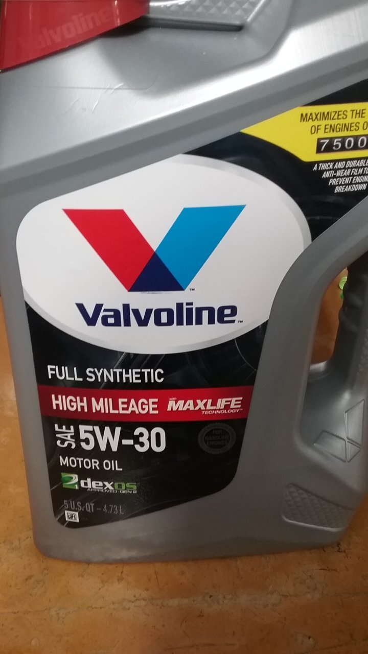

    I would use Valvoline high mileage full synthetic Maxlife. It's readily available in 5w or 10w30 in my area. If you have a Meijer near you they have it on sale right now.

    @Plain Jane Taco I recently saw Valvoline has 150 k mile oil. Probably a hype but I don't think it will hurt spending the same or slightly more. Can I use 10w-30 on the 2.7?

    You can use 10w30 without issue. Not sure how much benefit over the regular Maxlife (red bottle) there is. Both are synthetic blends. Valvoline also make Maxlife in a full synthetic (gray bottle).
    Edit: Having looked at the specs that Valvoline provides....I would save a couple of bucks and get the regular Red Bottle Maxlife. I don't see enough difference to warrant any price difference. The Black Bottle has a tiny bit more cleaning agent, but the KV100 is 11 on both and the anti wear additives are about equal.
    Bottom line? The Red Bottle is going to be the cheapest. But any of the 3 Maxlife formulas will serve you well.
