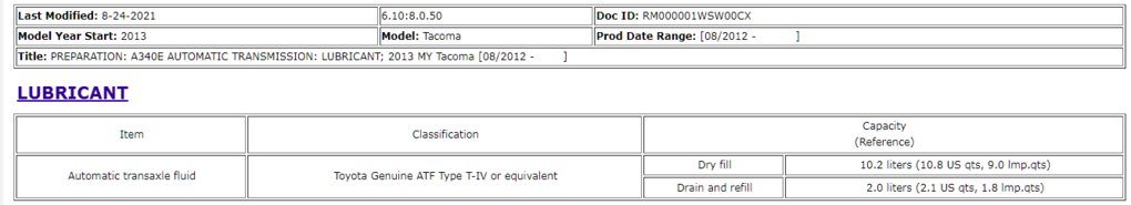

    So I refilled transmission fluid and now notice truck is sluggish at low speeds (especially from a stop). I used Toyota T-IV transmission fluid as my manual stated for a 4 speed automatic transmission. Worried I put in wrong type of fluid as not sure what else would cause this. Anyone with a 2nd gen 4cyl know if I used correct fluid ? (insert head explosion emoji). Thank You

    It's correct.

    I got 3.5 quarts out (Hayes manual says capacity is 2.9 quarts)... and put 4 quarts back in so you are probably right - I need to check the level today may be overfilled.
