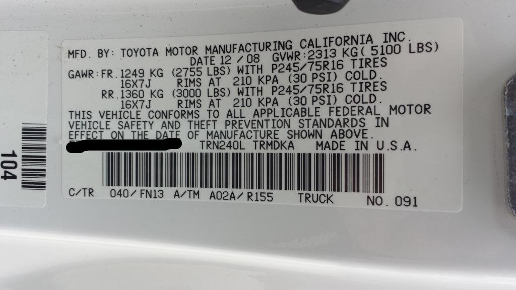

    Trying to decipher the towing capacity, if it's even on here. I have a big move coming up and had a hitch installed. Is the GAWR including the vehicle weight or is that additional weight capacity?
