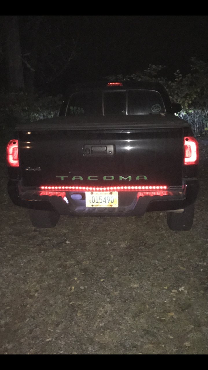

    If you go with the triple light bar the size of it won't let you get to the spare tire I went with the slim version an offset it enough to get the spare down if I ever needed it

    It still has rev light signal light and brake

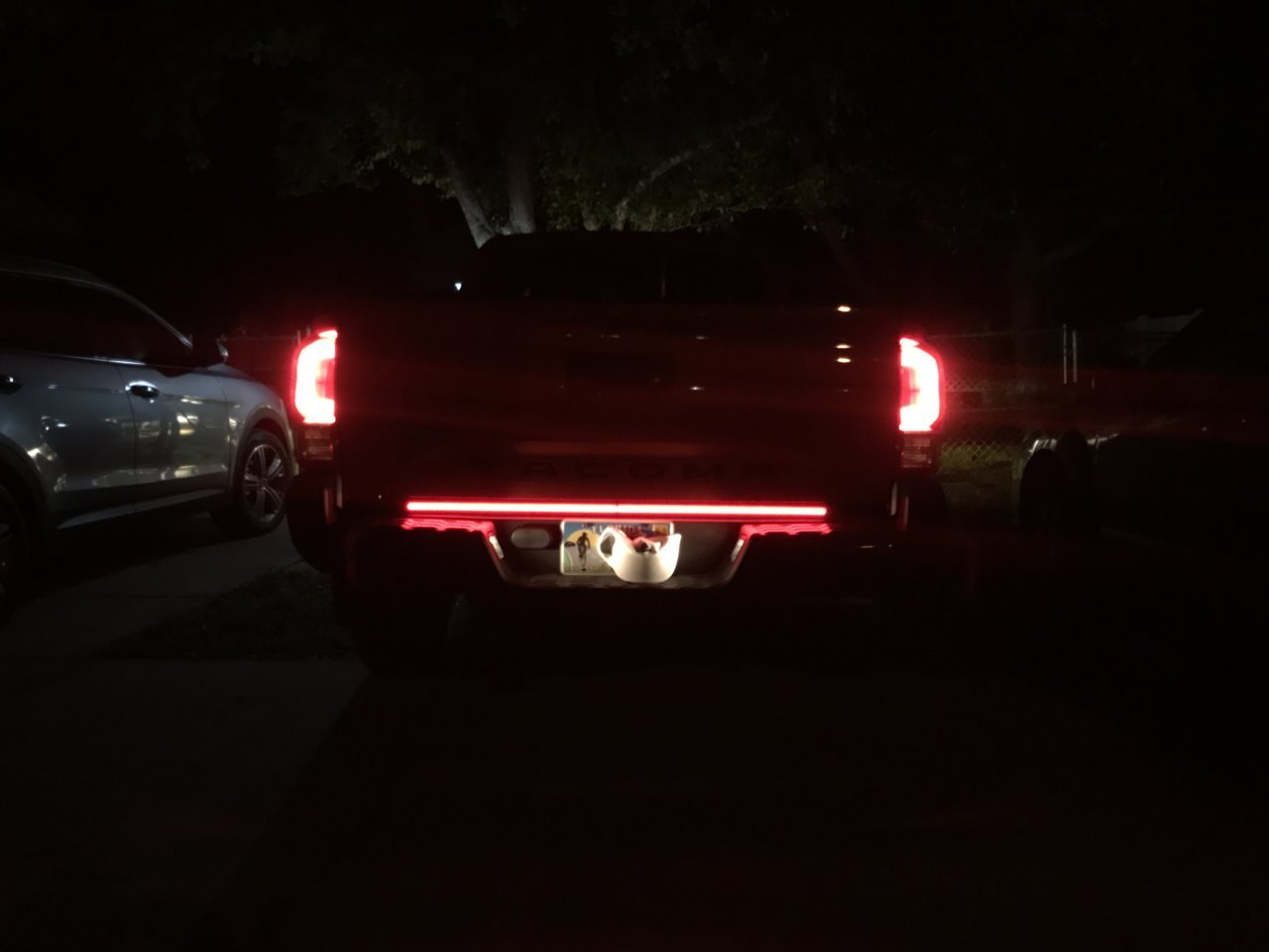

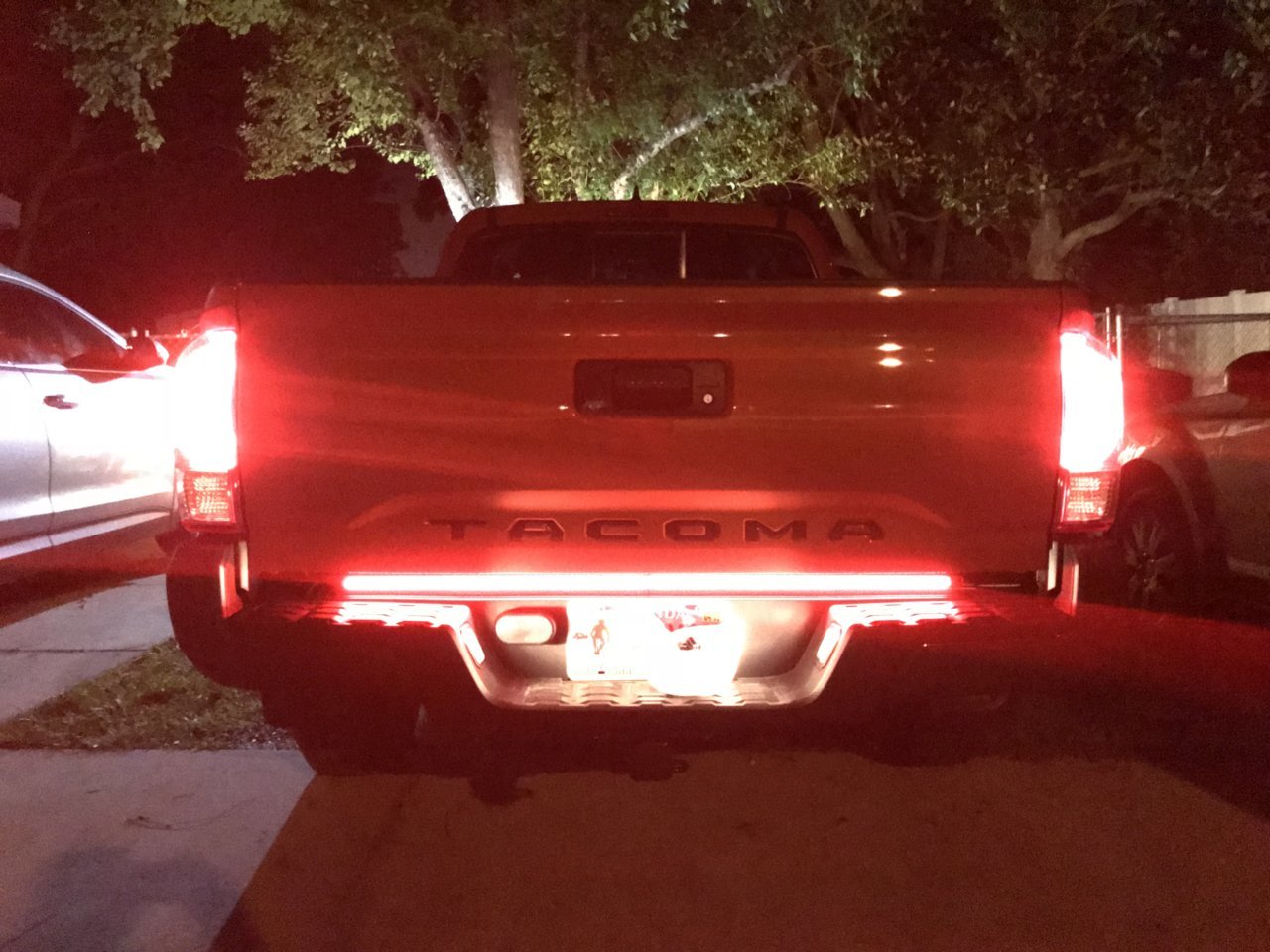

    Have the tailgate light installed. What I decided to do was one zip tie in the center and heavy duty double stick tape, approx 3 inches total per side.
    This way I can remove the light and get to my spare.
    Love the light. Yo, yo,
    3165E8DF-9412-4F4B-90BD-6D738B1295DE.jpg !
