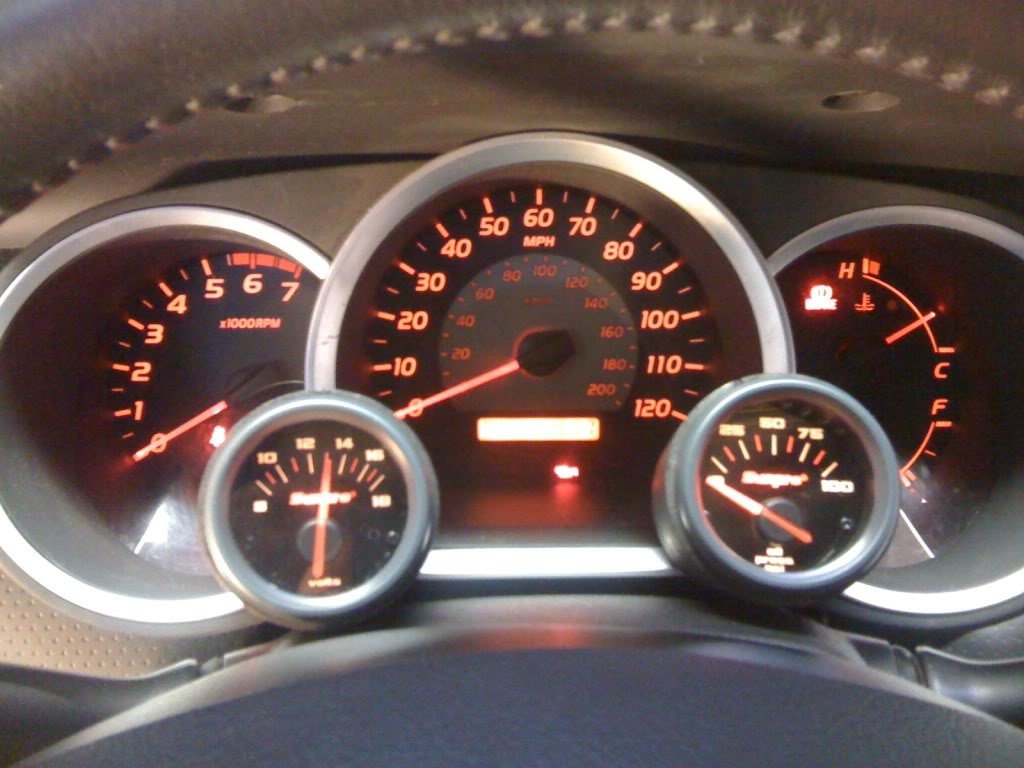

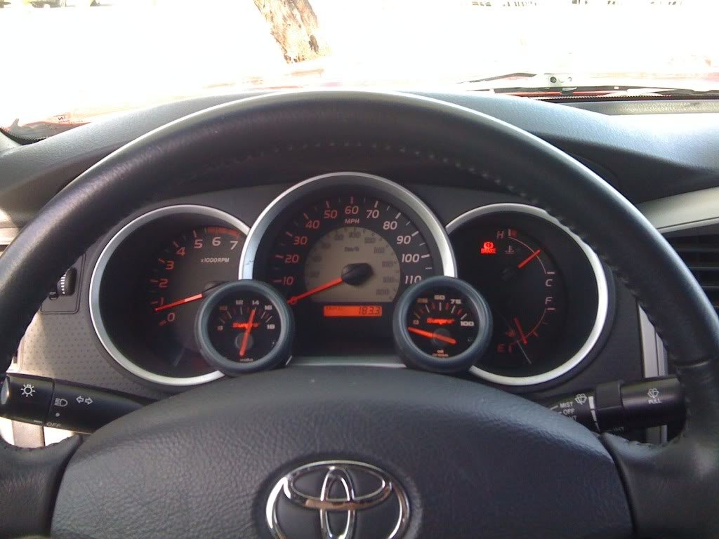

  20. Oct 28, 2010 at 1:24 PM
    #20
    MajorBurns
    MajorBurns Member
    Oct 25, 2010
    #45218
    6
    Jeff
    Phoenix, AZ
    08 PreRunner SR5 4cyl
    Nice setup!
    I'm going to try something else later on today, and I'm hoping it works.
    Here's a couple of pics of my setup:
    Daytime
    Evening
