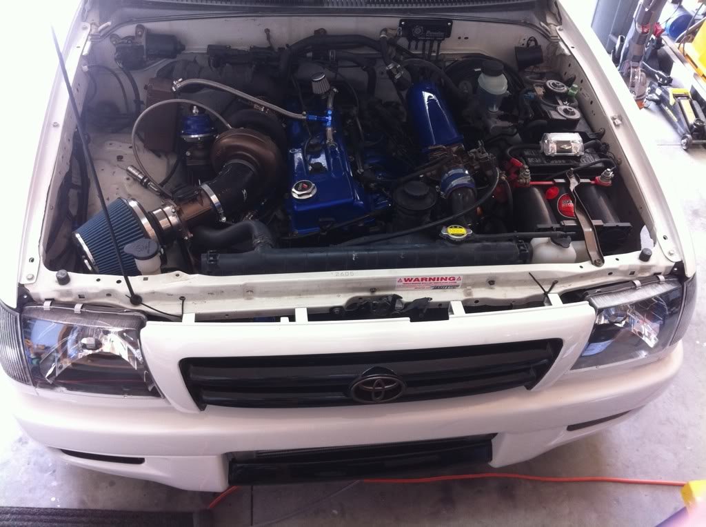

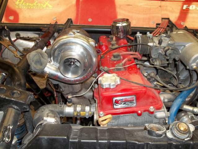

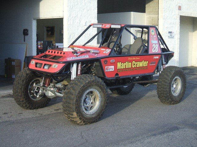

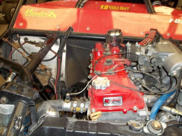

    Alright, this will be a bit over the top, and not exactly what your are looking for. But, it shows the potential of what your engine is capable of. However, yes, this is a 2.4L, with a HUGE turbo.
    2rz and he was running a Turbonetics T76, idk about now.
    We went with a water2air set up over our old air2air touched up the tune and yielded 790whp and 623ft lbs of torque with a spike of 807whp.
    We maxed out the a1000 pump at 33psi.
    We went to irwindale tburs ur couldn't stay in it.
    Last night we made the trip to Bakersfield and off the trailer we blasted out a 8.98@152 mph. Made 2 more passes both 9.2@ 151 and 153 mph
    http://www.youtube.com/watch?v=dSDNHsFO9Ec&feature=player_embedded
    Here is the full story> http://www.customtacos.com/forum/showthread.php?t=155949&highlight=santos&page=2
    Here is some more decent info on base 2RZ numbers and with less boost than the graph above.
    http://www.customtacos.com/forum/showthread.php?t=153222&highlight=santos
    That will be a little eye candy. ^_^
    Now, getting down to details on what size turbo and what kind of power can be safely attained. Then I will do some digging on supercharger specs.

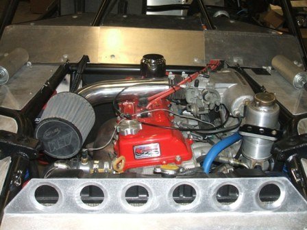

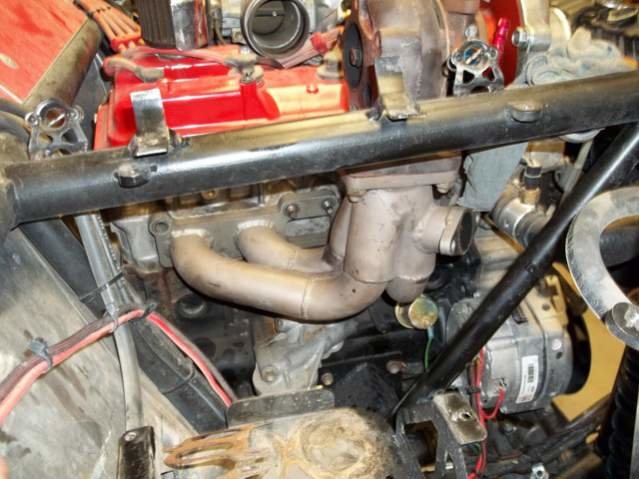

    3RZ rock crawler.
    Now, before I post any more eye candy, I will ask this.
    How many miles do you have on your engine? Reason being, no matter which boost path you choose, you should seriously consider installing a new MLS Cometic head gasket, and some ARP head studs.
    They will prevent the stretch that can happen from the factory bolts, which will cause the head to slowly lift under higher cylinder pressures from boost.

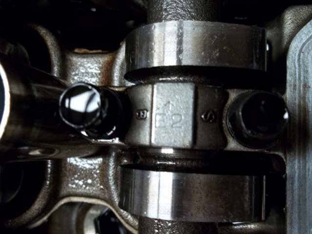

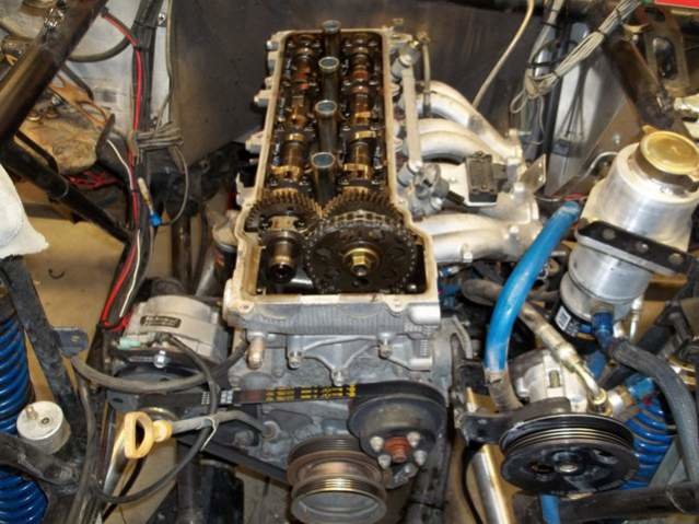

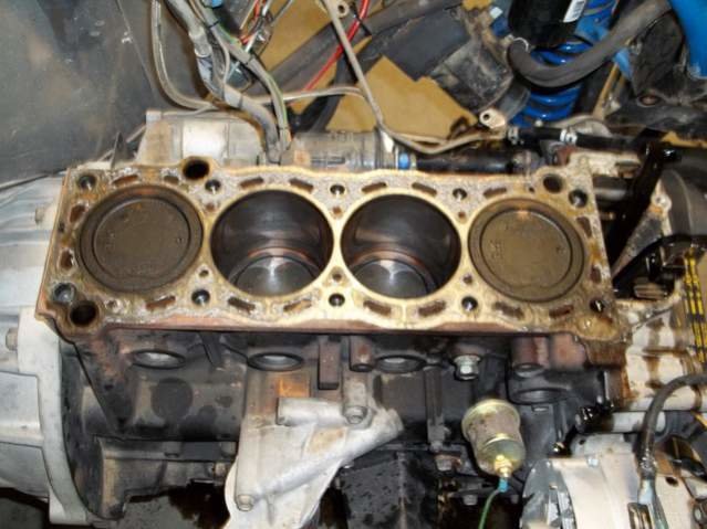

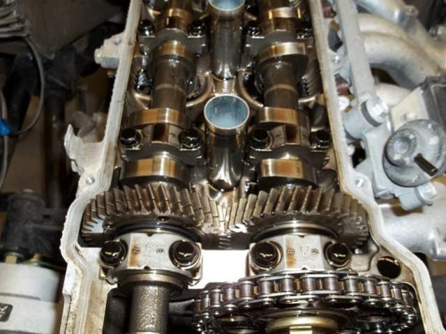

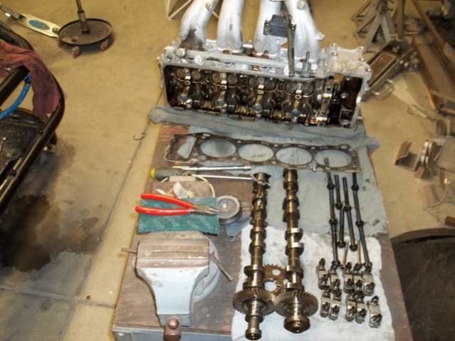

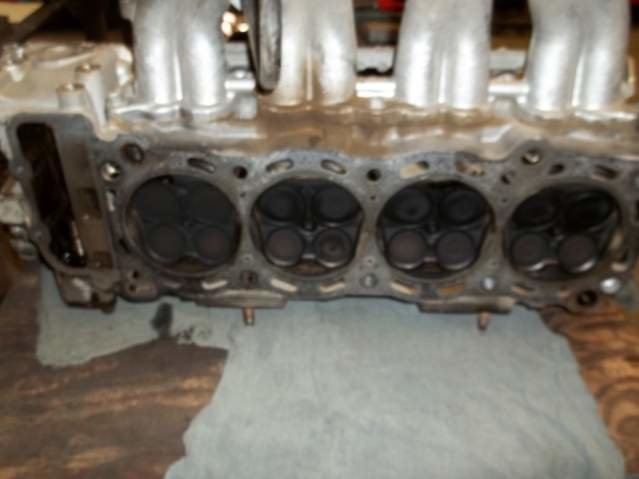

    Here is the info for removing the head and installing the ARP studs.
    "I have never had a 3rz apart but I figured during the disassembly I would wing it.
    Next I turned the motor to top dead center #1 cyl and made a mental not of what the timing marks looked like.
    Then I removed the cam gear and cam shafts. I noticed that the cam shaft bearing hold downs were marked so I would have to worry about getting them mixed up. I kept everything in order anyway. "
    "Once I got the cam shafts off I could get to the head bolts. After removing the head bolts, the head came right off.
    the motor came out of a junk yard so I have no idea how many miles are on it. there was a little carbon buildup but the cylinders looked and felt great. the head gasket surface also looked to be in good shape. I'll know more when I get everything cleaned up. "
    All of that, as compliments of Desertoy, on CT. I should start a thread specifically for the head studs. Very useful information.
