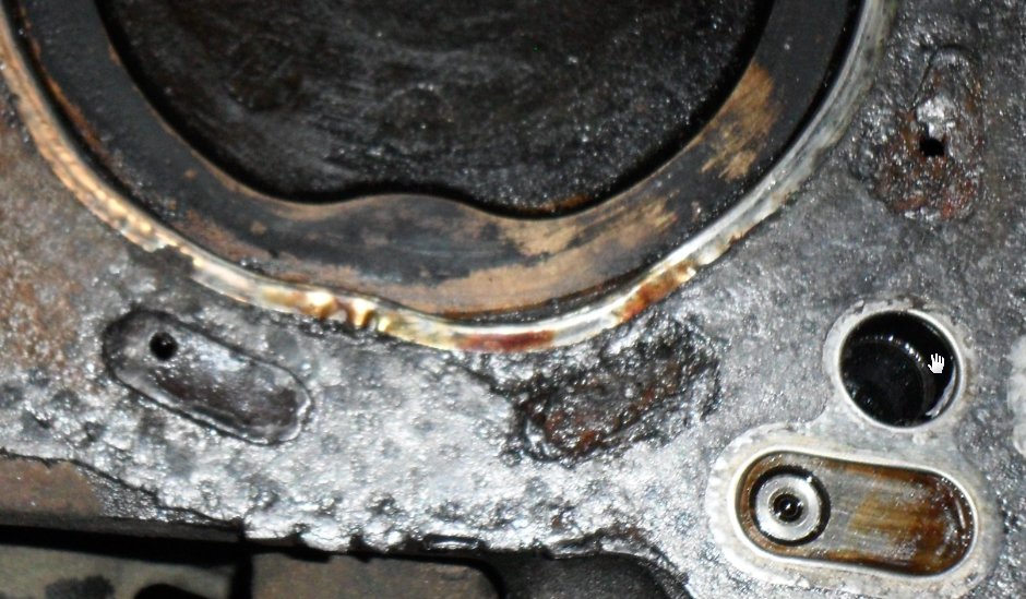

    Visible cracks between intake and exhaust valves on 2 & 3. There must be more internal cracks that can't be seen that caused coolant to flood #2. I did not check valve clearances before pulling the cams to get the heads off, but I'll bet they were tight.

    This is my cyl no 1 :
    That little bent in the gasket caused coolant leak into cylinder when not running and exhaust gasses bubbles in coolant when engine was running. That little bent made the engine run on 3 cylinders for few seconds on startup and the lean on three other cylinders (not throwing the code, just high Nox during CA SMOG).
