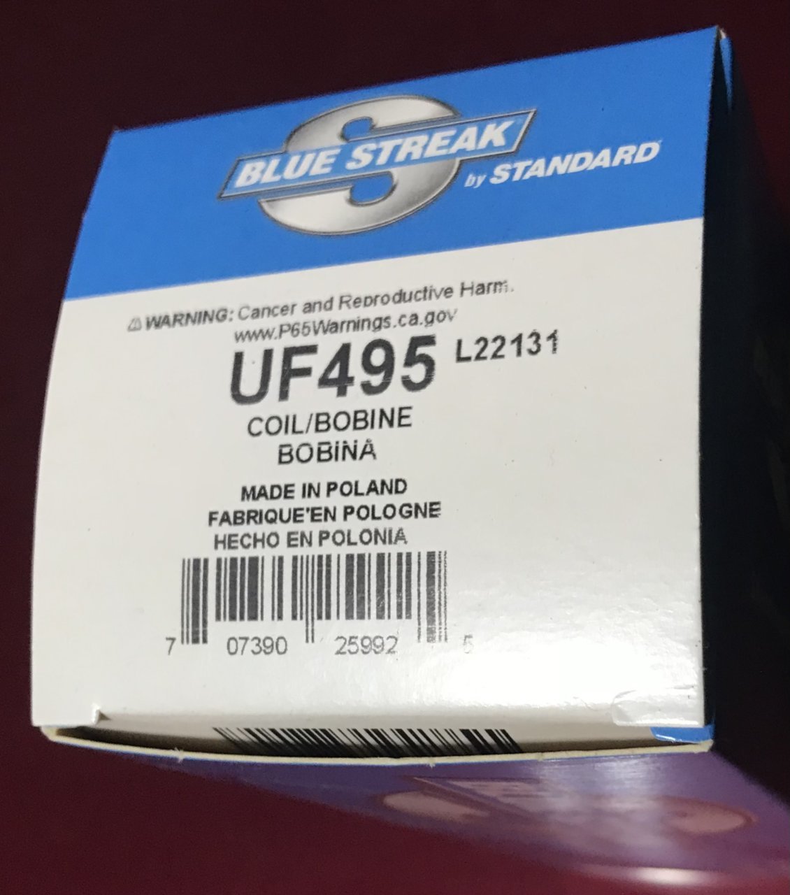

  20. Apr 2, 2023 at 5:32 AM
    #20
    Steves104x4
    Steves104x4 Well-Known Member
    Apr 17, 2010
    #35468
    17,067
    Steve
    Buffalo NY
    2010 RC 2.7 4x4
    BUCKLE UP! It makes it harder for Aliens to pull you out of your Truck.
    D5A06360-7779-4ECD-9C7F-2F95503068DE.jpg I should have dumped the oe coils a loooong time ago.
