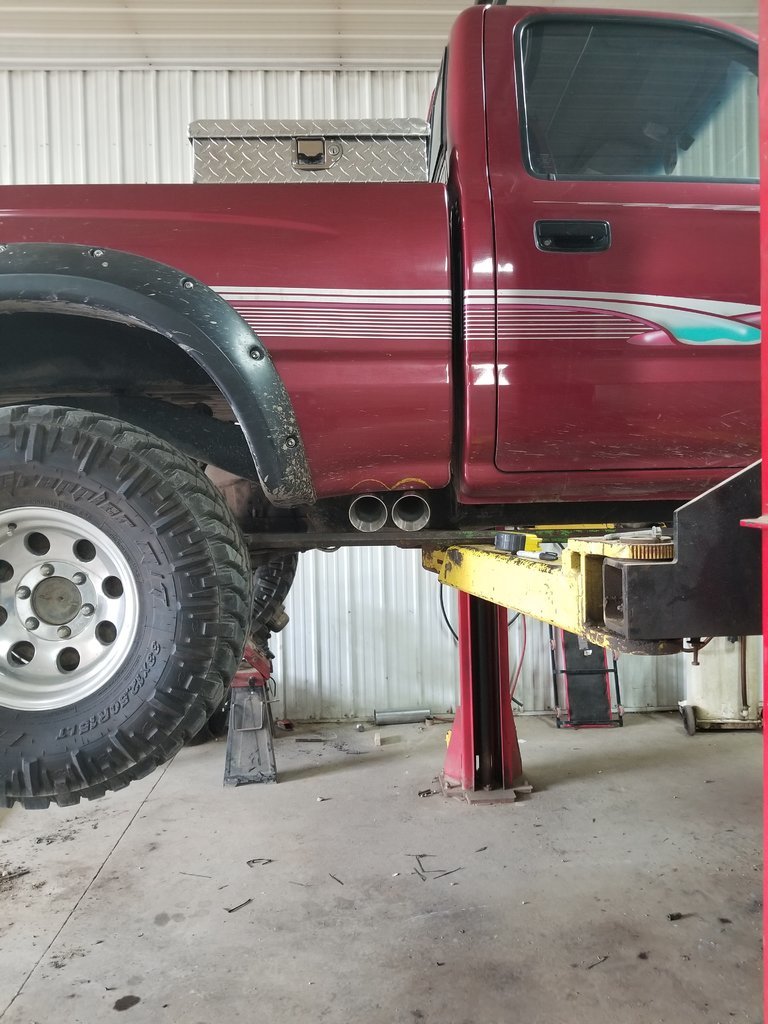

    I've been doing a little mockup for a side dump in front of the pass rear wheel. I have a question about cat delete using a urd rear sensor simulator. So I'm planning on removing the cat and bolting the rear flange to the downpipe and leaving the o2 sensors in their factory location. Will I have issues with the up and down sensors being so close together or will the simulator just work?

    Yes I do. I'm tucking them up an inch or two higher than they are in the picture. Eventually sliders will be made but that's after a lift. I can't afford any more weight without a lift. Right now it is a on road truck. Stock hight and 33 12.5 is a good combination for lots of tire rub.

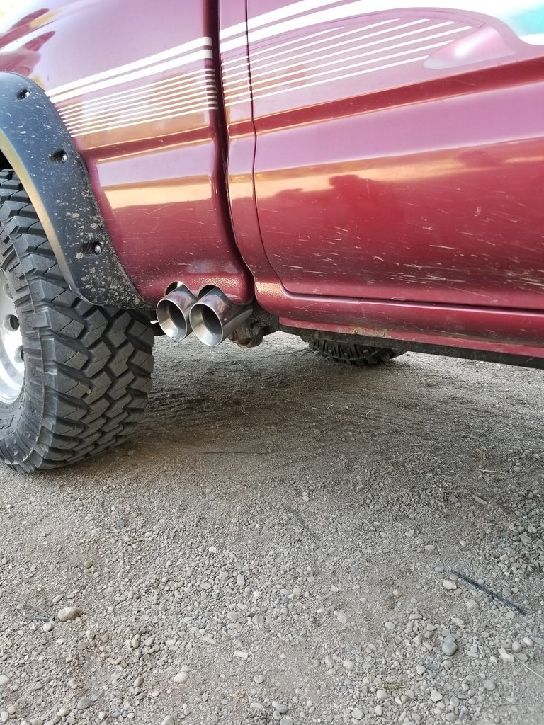

    Got it done sounds amazing pics soon...

    The CEL came on about 10 miles after I removed the cat and after I cleared it 3. Once i get the simulator i will do an update.
    I still have a couple hangers to add and it will bring it up and in a bit.

    Those cutouts look sweet!! Nice work! What did you use to cut the body?

    A 3" cutoff wheel and then just deburred with a dremel bit. I'm going to put some of the extra trim for the flares on the edge.

    Does it seem louder as a side exit closer to the cab?

    It was stock before... Yeah it's loud. I did a cat delete, dynomax ultraflow welded 2.5 in and out. Also the little bit of pipe to the exit is 2.5 hand made corners and tig welded. No idea where the tip came from ive had it for years.
