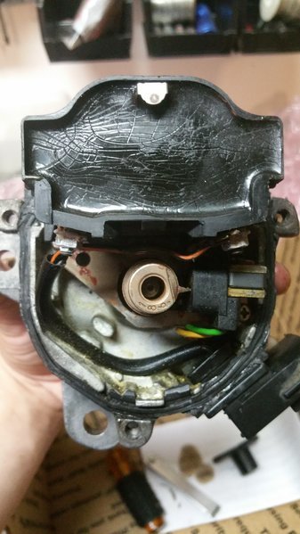

    Well boys I think the mystery is solved and I have to give mad props to @DrZ and everyone else who led me to believe this was a distributor/coil problem. You guys are the best! I went ahead and scored a junkyard denso distributor for 40 bucks from an old 95 tacoma. It passed all the resistance checks and the coil looked good. I swapped it in and drove around for a while and the issue seems to be totally resolved!
    I should add that the second I took the old one out it was obvious that it had a problem. The coil was a mess. I'm not sure why I never looked at it more in depth, but I chalk it up to lack of knowledge at the time. I have learned a lot throughout this process on 3RZ fuel delivery and ignition systems. A picture of the super cracked coil that I replaced is below....what a mess (I'm also not sure if it's oem, may have been replaced along the way, I see no Denso or TOYOTA markings like I do on the one I replaced it with). And for reference when I do an ohm check on this bad coil it jumps all over the place and way out of spec.

    The Toyota coils I've seen have an orange/yellow translucent appearance with the Toyota part number printed on them.
    There's something about this generation of Toyota distributors, the ones with computer controlled timing advance, that make them cause weird symptoms when they go bad. Maybe the coil starts arcing at certain RPMs and screws up the electronics controlling the timing or something. I'm not sure. The good thing is they don't fail and leave you stranded. The bad thing is they cause symptoms that lead you to believe it's a problem somewhere else.

    Yep, that's what the one I replaced it with looked like. It was a yellowish color with TOYOTA written across it. On the top it had the Denso part number. Very happy to have this problem solved, now I can get back to the fun stuff.
