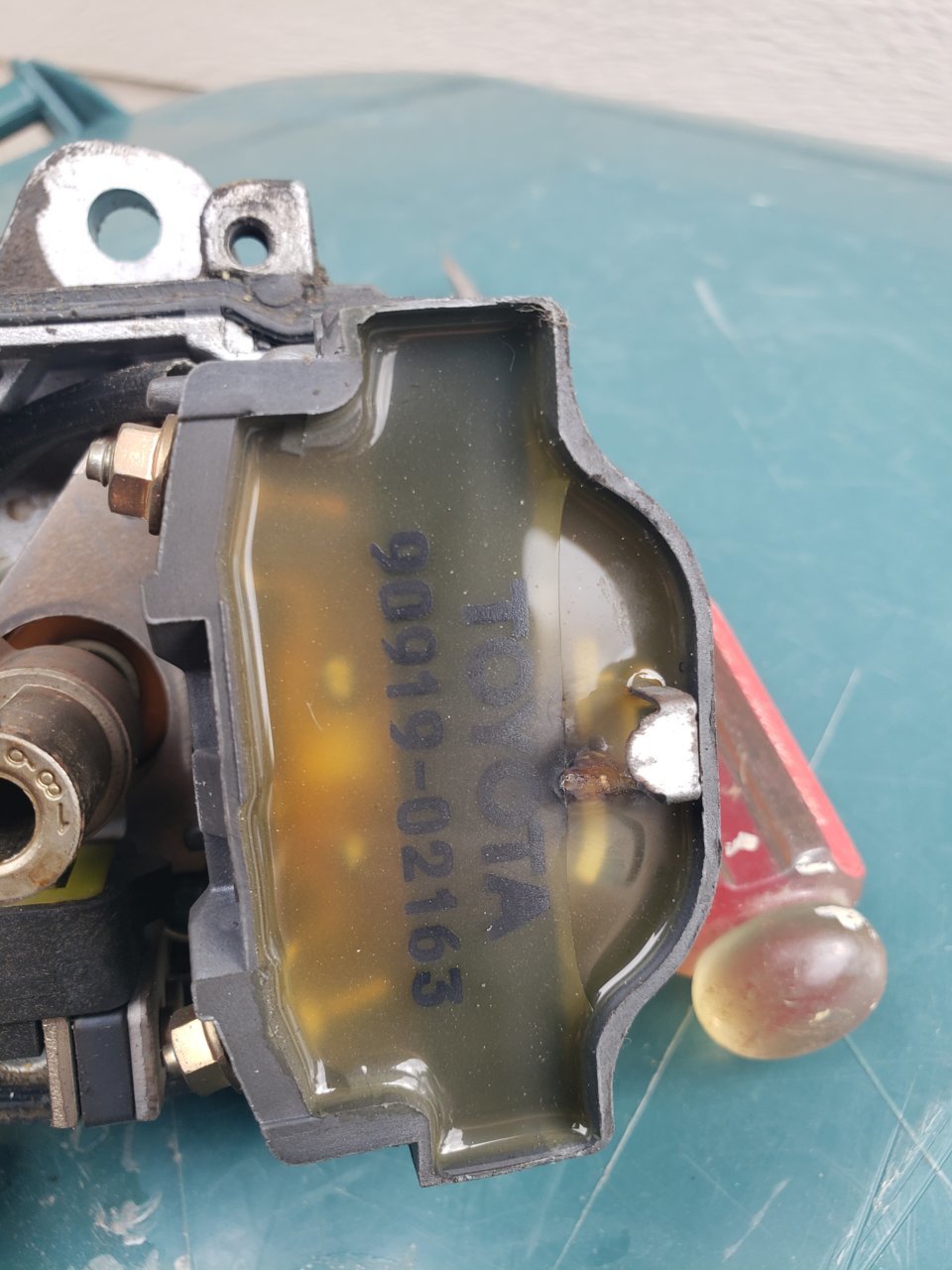

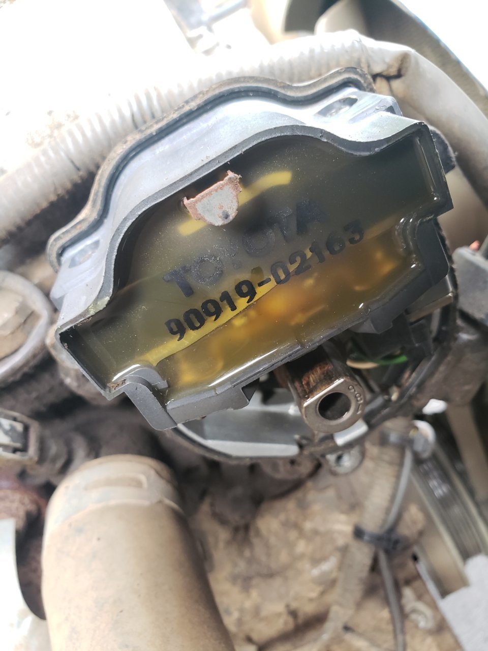

    #54
    SnowroxKT
    SnowroxKT Well-Known Member
    Dec 11, 2011
    #68604
    5,319
    Kyle
    Anchorage Alaska
    2008 TRD OR
    Son of a bitch.
    This is the one on my truck at the moment.
    And this is the spare that Green Tree Fab loaned me to use while troubleshooting...
    The really bad one was what I took in to GTF 1.5 years ago and my truck wouldn't run hardly at all. They had swapped entire distributors with one of their old race truck motors and my really bad one.
    This resulted in my truck running maybe 75% overall, but about 50% power from 1900 RPM to 3500 RPM with seemingly random sputtering and almost lack of total power. Also, my truck has run rich for years... also causing a P0420 condition, probably because I wasn't getting excellent spark all along! I recently just did the O2 sensor mod on my rear O2 sensor so I won't see that no matter now.
    So I leave for hunting in the middle of no where Friday, just ordered a new NGK coil from RockAuto for $45 shipped, and to be sure I'll have one before I leave I'll be buying a used one from Ice Monkey Garage here in town too. So annoyed I didnt find this like 3 years ago when this started acting up. Thanks a ton for this thread and @SOMDTACO for sending me the needed docs.

    Did you actually do any ohm testing on the coils to see if/how out of spec they are? At least you had a genuine toyota distributor. When I pulled mine out it was clearly aftermarket crap.

    Yup. I tested it and it was out of spec on a couple of the tests.

    Well that's actually good news then haha. Looks like you found the problem. Interested to see how that new coil works out.

    Runs like a raped ape again!
