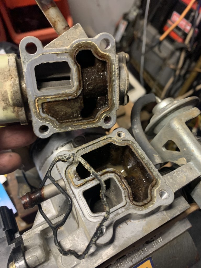

  9. Nov 22, 2024 at 10:04 PM
    ControlCar
    ControlCar My Moto: Help & Learn…period.
    Jul 22, 2023
    #429578
    3,601
    Steven
    Sugar Land TX
    1996 Taco 2.4L 2wd Automatic
    Clock Volt meter/LSPV Delete/Hyundai 16’s/FP gauge/after 9months of wrenching ZERO oil leaks
    yeppers
    Mine at 212k….no issues
    But I was “in there” might as well just clean

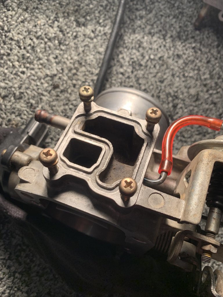

  10. Nov 22, 2024 at 10:05 PM
    ControlCar
    Jul 22, 2023
    #429578
    3,601
    Steven
    Sugar Land TX
    After:

  11. Nov 23, 2024 at 1:28 PM
    THatt
    THatt Well-Known Member
    Aug 23, 2022
    #404202
    1,068
    Upstate SC
    1996 Tacoma 2.7L MT 4X4
    Not sure how the IAC would make it surge during acceleration but didn’t see anyone mention TPS. Those can do some weird stuff if they are failing.
  12. Nov 23, 2024 at 2:52 PM
    DoktorSlowburn
    DoktorSlowburn Well-Known Member
    Aug 28, 2024
    #456061
    206
    Escondido, CA
    1997 White Tacoma SR5
    4runner seats and center console, ARB rear locker, Icon 1.5” AAL, Bilstein 5100 on 4th notch in front (to support future tube bumper & future winch), 4600s in the rear. In-Cab CB radio. Hella 500 Driving lights. All-Pro Baja front bumper.
    OP said TPS has been replaced. IAC can cause similar issues to what has been described, I wouldn’t completely rule it out. At the very least it’s worth cleaning it.
