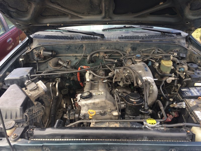

    How many wires are coming out of the black box on top of the aluminum tube that is attached to the airbox?

    I haven't gotten the truck towed to my house yet to look, but I will as soon as I get it here. If there is 5 wires does that mean the engine wI'll hook right up? Thanks.

    It will definitely be closer. You may have some tiny changes in EGR and EVAP system but generally you just have to transfer the old stuff to the new engine. May need to put your old throttle body in as well.
