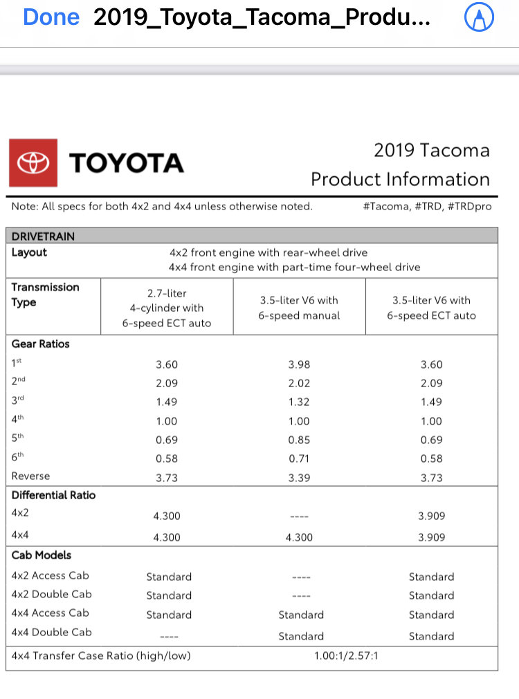

    Haha not a lot is it. But that’s not the whole story. The 3rd gen 2.7L automatic has a 4.30 rear end compared to the 3.5L automatic 3.91 rear end. And what rpm is the power and torque at? Quoting from another excellent post:

    All 3rd gen MTs come with 4.30 rear end as well ;)
    Maybe thats why i dont understand the lack of power complaint from some owners?:notsure:

    Yes, it just might. And I knew that ;) And your MT also has stronger 1st -6th gear ratios. I had manuals for many years though and it’s time to let the transmission do the work for me :)

    Based on your MT gearing I have no doubt you have the fastest stock 3rd gen out the gate. And for a 2.7L, my Tacoma 4.30 diff would have drug my 2007 Colorado all over the place in first gear, it certainly has good low end gearing and torque.
