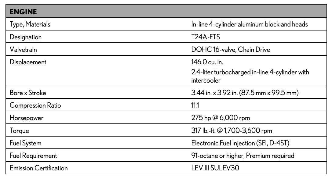

    The next-gen Tacoma is rumored to get the 2.4T from the Lexus NX350 with 275 hp — and, more importantly, 317 lb-ft at 1700 RPM — though power might drop slightly if they tune it to run on 87.
    I would rather have that than either existing Tacoma engine. Give it a little gas, it spools the turbo and powers up a hill without downshifting.
