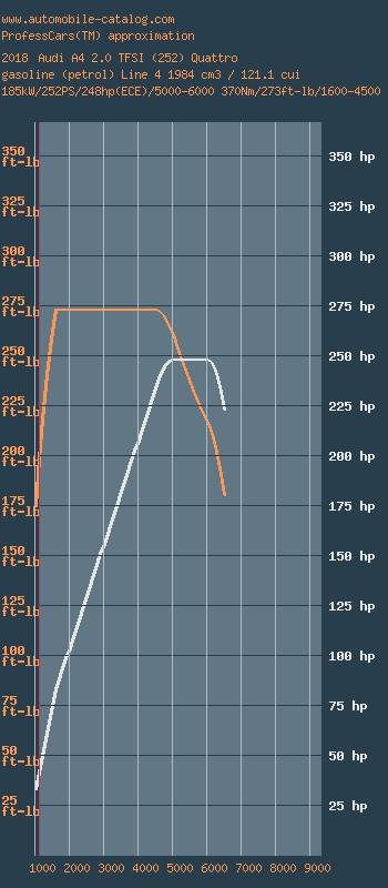

    here is a hp/tq curve of an Audi. Look at the torque curve. This would be great in a truck. 34AD1919-5B56-490C-AFAD-E5EBE8657D7A.jpg

    I was gonna throw out there that my Gti made peak torque @1700 all the way to 4600 RPM. It would be amazing in a Taco of any generation to make power that quick and flat.

    They flat move. 0-60 low 5 sec, 40 mpg on the highway. I would love a powertrain like that in my Tacoma.

    Older turbo engines were generally normally asperated engines with an off the shelf turbocharger piped in with less than ideal plumbing arrangements due to space and placement constraints. Turbo lag and other undesirable operating characteristics were common.
    Current turbocharged engine packages perform much better with virtually no turbo lag and a very broad torque curve due to engineering advancements such as optimally sized turbochargers, twin scroll turbines, shorter exhaust distances, generous intercoolers, specific more robust engines, etc.

    Very impressive for sure. It would be perfect for a truck like ours.
