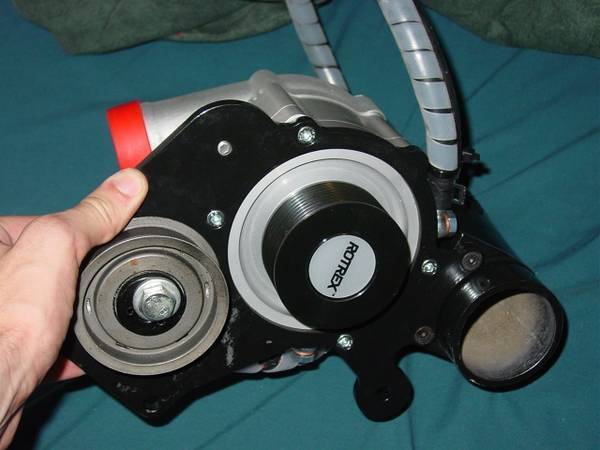

    Teaser pic
    Won't get a break for a while. Will install it when I have time.

    Was able to take a peek at the fuel/timing map they sent me. Looks like it's aiming for a 12.x AFR at WOT and max rpms @ around 85-90% duty cycle on the injectors. Also, apparently they can get 95 octane fuel at the pumps in South America, so they were able to advance the timing a bit. More at low rpms, down to nothing at high rpms. I can get 93 at most gas stations around here, so I'll probably end up pulling that down a bit.
