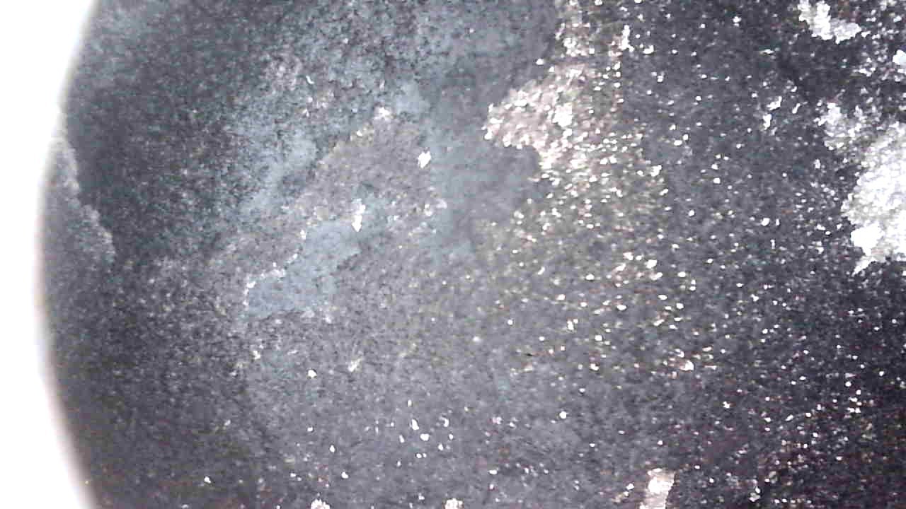

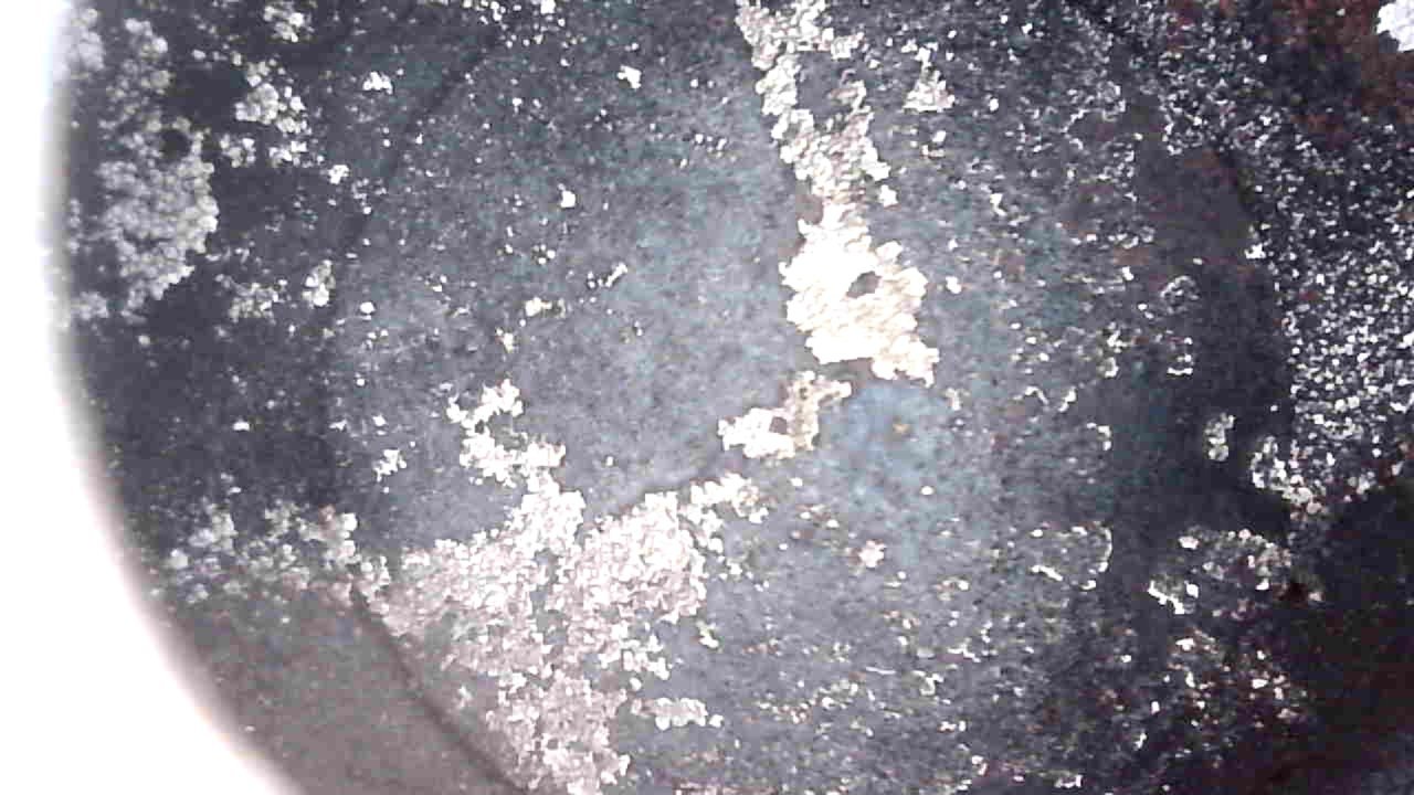

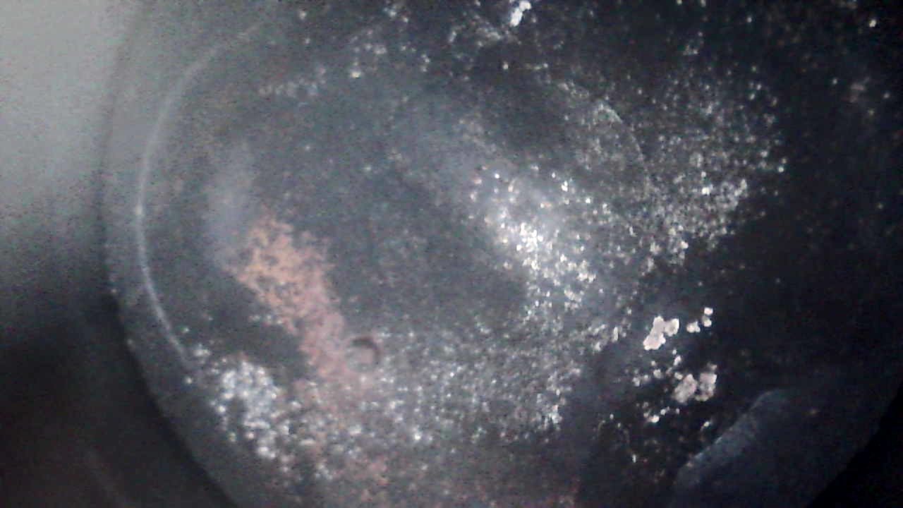

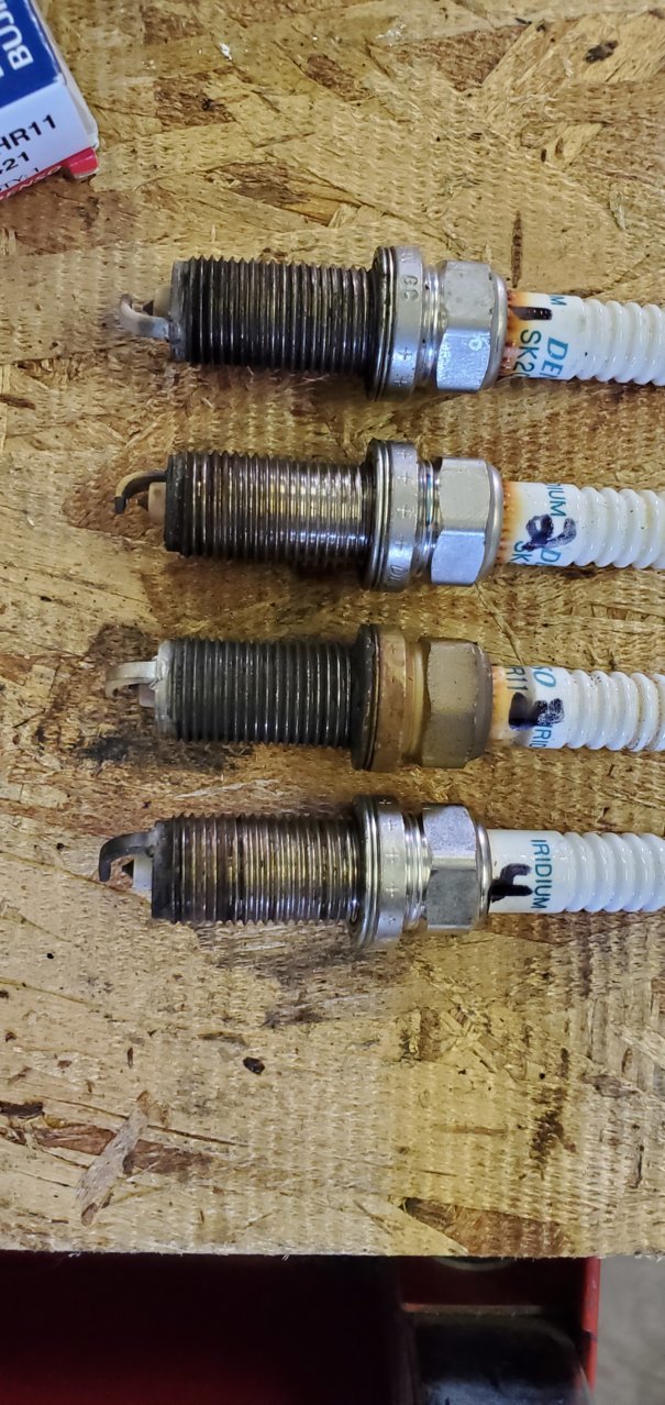

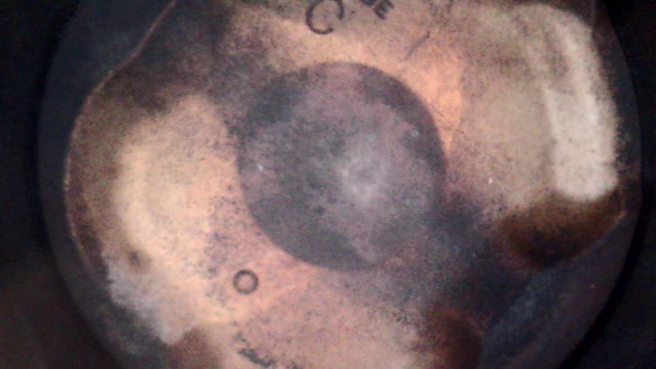

    20230730_192639.jpg 20230730190726774.jpg 20230730190747622.jpg 20230730190803722.jpg 20230730190815419.jpg My results of the day are: Compression results 1=140 2=125 3=125 4=140.
    Spark plug 1 and 3 not tight, 4 looked newer than the others and 4 had a replaced generic coil/ not denso toyota. Put in new plugs.
    Pics of piston tops 1-4, 4 is the tan one.

    I'd wager you're in Colorado based on your compression numbers. Otherwise are you at high altitude?
    4 is odd, I wonder if it had a recent misfire and was repaired prior to your purchase. 1-3 look normal.
    2 and 3 may be lower for a number of reasons, on older vehicles it was due to carbon prioritizing the 2-3 simply due to the EGR placement (not this engine) and intake manifold inlet position. (Caused by PCV recirculation) Also heads naturally bow a bit over time.
    Does your borescope have a side camera to take a pic of the intake valves? Otherwise removing the intake manifold is the only way to confirm visually.
    Leak down tests can find this as well, but its not a typical tool purchased anymore.
