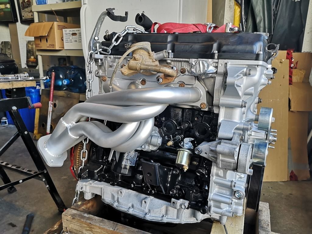

    I love the 2.7 2tr I think it's one of the best 4cyl engines put out. It's great in its stock form and even better when you mess with it. Mine unfortunately needed to be rebuilt after the piston rings failed. So it was bored 40 over, cp forged pistons were installed along with hastings race rings to give me options down the road, stayed with n/a compression as I would only ever supercharge it. All new seals valves etc, retained the stock cams, Lce header, clutch kit, magnaflow 2.5 exhaust no emissions, and I woke up the r155f with a core/Hurst shifter kit
