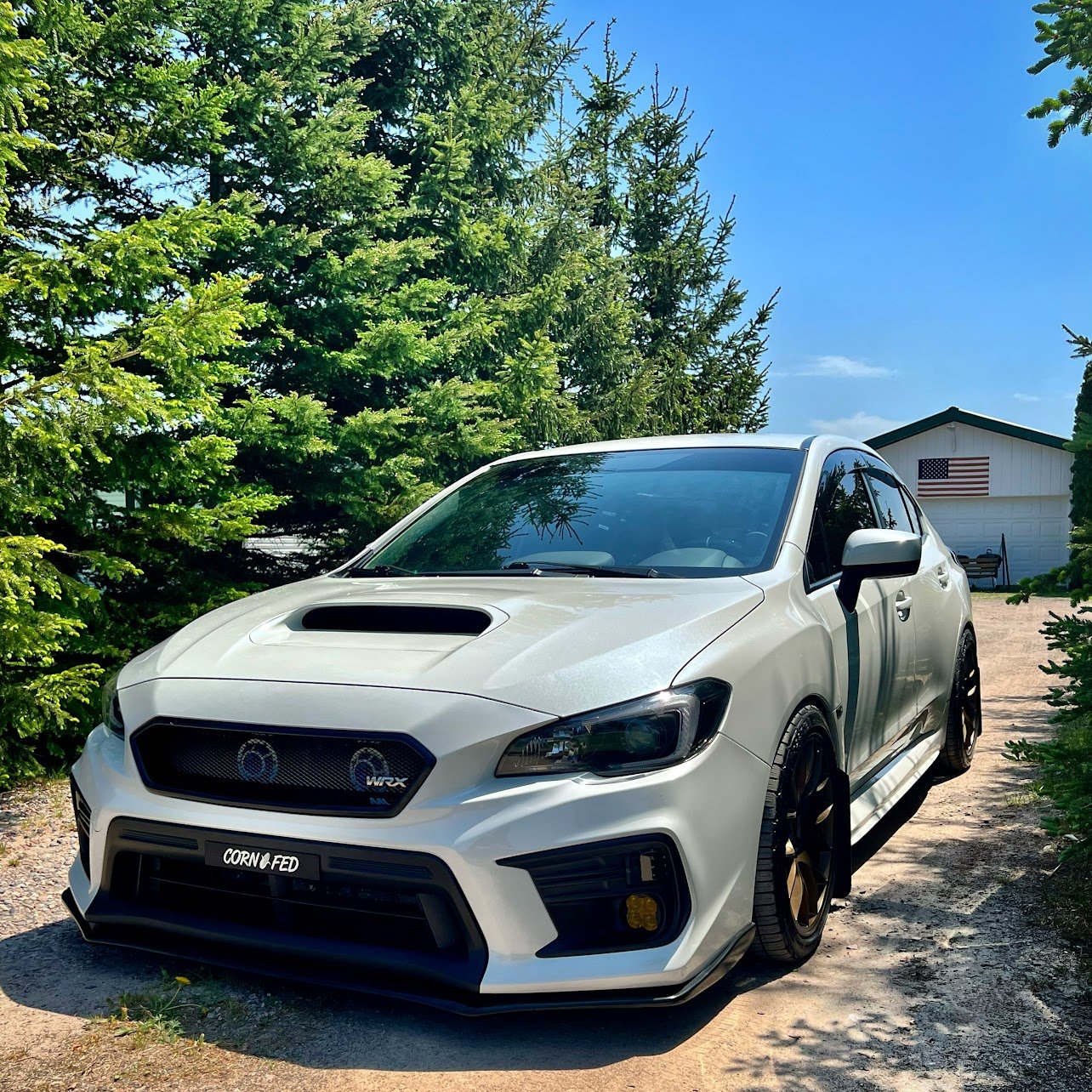

    I like my truck being an automatic. Just care free, and my girlfriend can drive it. I have a manual car when I wanna hit the twisties. 420whp E85 tuned WRX with full bolt ons and upgraded turbo/headers and complete STI swap tranny and suspension

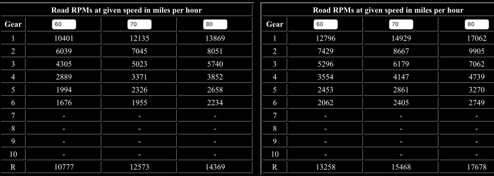

    I found a great gear ratio calculator if you’re interested or thinking about re-gearing:
    http://www.grimmjeeper.com/
    Here’s a screenshot - stock 4.30 gears on left, 5.29 gears on right
