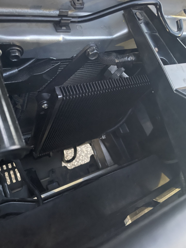

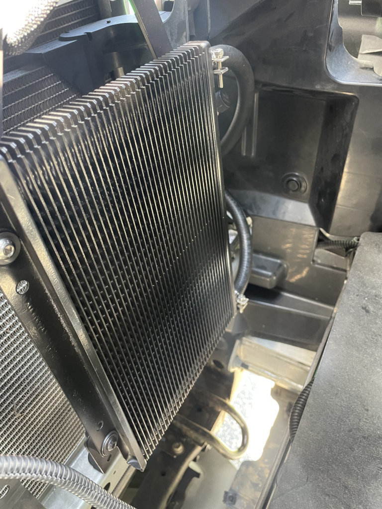

    I did not know they no longer offer it but could see that happening since the converter unlocks and starts to generate heat. You have to have some common sense which in todays day and age is hard to find. I threw on a trans cooler a while back for the few times i tow something and figured it would help the overall life of the trans. I also have obd fusion with the dongle so i can monitor my trans temps in carplay, gear lock is neat at times but does not help much with highway driving not missing much. The gears and tune with s mode i never felt the need for ect function so figured why not have gear lock instead. Keep your eye out for a used header would be a worth while upgrade.

    That's funny, we must think alike. I also have odb fusion to monitor trans temp. I hit 240 degrees pulling a long mountain grade (stock gears, 3rd gear WOT) which now has me wanting to add a cooler. Interesting observation; the trans runs cooler in 4th than any other gear. As soon as it shifts down to 3rd, or up to 5th, the temp starts rising. Probably has something to do with torque converter lock-up. I'm hoping the new 5.29 gears helps with this. Header sounds good...so does a supercharger, but I need to keep myself in check. I added a nitrous button but it doesn't seem to help:)

    There is no converter lockup until 4th that is why and likely could be unlocked in 5th if youre under heavy load. I know other tuners do but you could talk with OTT they may be able to give you lockup in 3rd which should help temps but still grab a cooler. I picked up a trucool LPD 4454 it was like $100 bucks, i grabbed some better stainless clamps, aluminum stock, and rubber bushings to mount it but comes with everything you need. Its overkill but thats how i like it, cooler is twice the size than on a stock 3.5. Super easy install and for the money its no brainer, i could be wot up a mountain for 10 minutes straight without the trans getting too hot with this cooler. The truck cant produce enough power to generate enough heat to outwork this setup. If the budget allows you will be happy with the header, i also removed the charcoal filter in the top of the air box and added a afe drop in filter. Likely does minimal but placebo effect says it picked up 5hp, revs more free feels less restricted. When you have a vehicle this heavy with this little power what would be minimal to other setups is felt here. Like the nitrous button maybe you just need to up the jet size lol, hows the side center console saddles was looking to maybe grab them.

    I like your cooler setup - thanks for sharing. Yes, I like the console saddles - great place to stash little stuff. I was afraid they might rub my leg while driving, but I don't notice them at all. Amazon $25

    Alright, you sold me on the trans cooler. Got one ordered should be here next week. One last question - can you confirm the top line to radiator is “in” and the bottom line “out”? As I understand it, the fluid should run through the radiator first then through the aux cooler? Thanks

    Cant beat it especially for the cost and ease of installation. Correct take the bottom line off, connect your new line to the bottom of the radiator then to the top of the cooler. Other line goes bottom of cooler to the hose you pulled off the radiator. Extremely easy took a little time just making the brackets nice, round the corners, added some rubber mounts, paint em black etc. Just depends how clean you want to get, amazing how much lower the trans temps are. There is a spot on the radiator support where the lines can feed through, i used some of that rubber edge banding just so the lines couldnt rub on the metal. Could also just slice an extra piece of hose too, get an extra qt of toyota atf it took 1/4-1/2. I used a small funnel to fill the cooler/lines the best i could. Filled the hose coming from the bottom of the radiator that goes to the top of the cooler and left it hanging up to not drip. I then attached a small hose to the top of the cooler when it started to drip, i yanked off the small hose and quickly attached the prefilled line that was attached to the bottom of the radiator.
