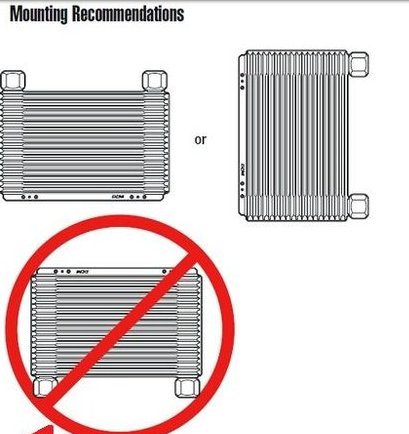

    Nice setup on the transmission cooler, i'm planning on installing one. I'm contemplating eliminating the radiator and running the cooler only. Your setup it shows the hose go to the cooler horizontally, just for clarification your "inlet" is the top and "out" is the bottom? Reason for asking, when I was doing some research I came across these images below. To prevent air pockets the inlet is recommended to be at the bottom.

    I have always mounted my coolers sideways and the inlet top and outlet bottom. Ive put them on hot rods to tacomas that way without any issue. In theory I guess it could but also more strain on the pump. The stock configuration is inlet top of radiator outlet on bottom for what it’s worth

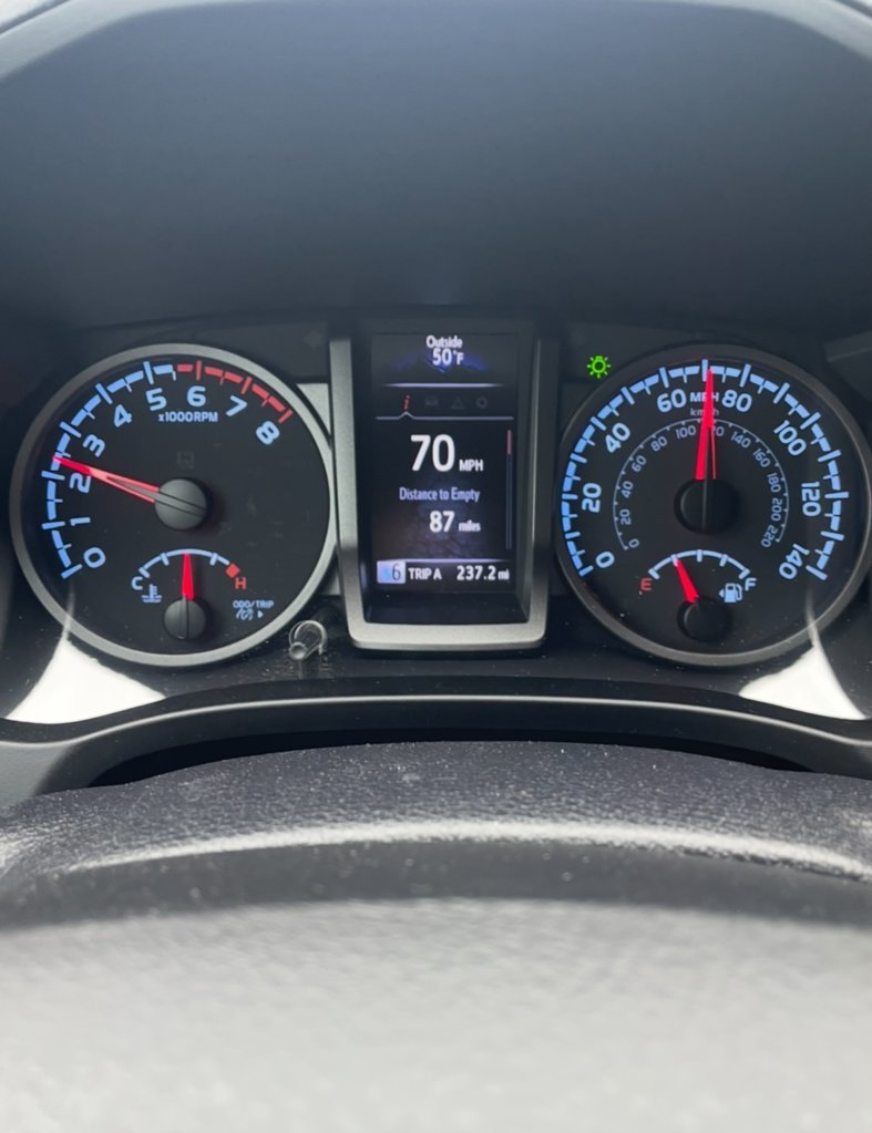

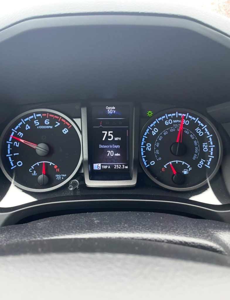

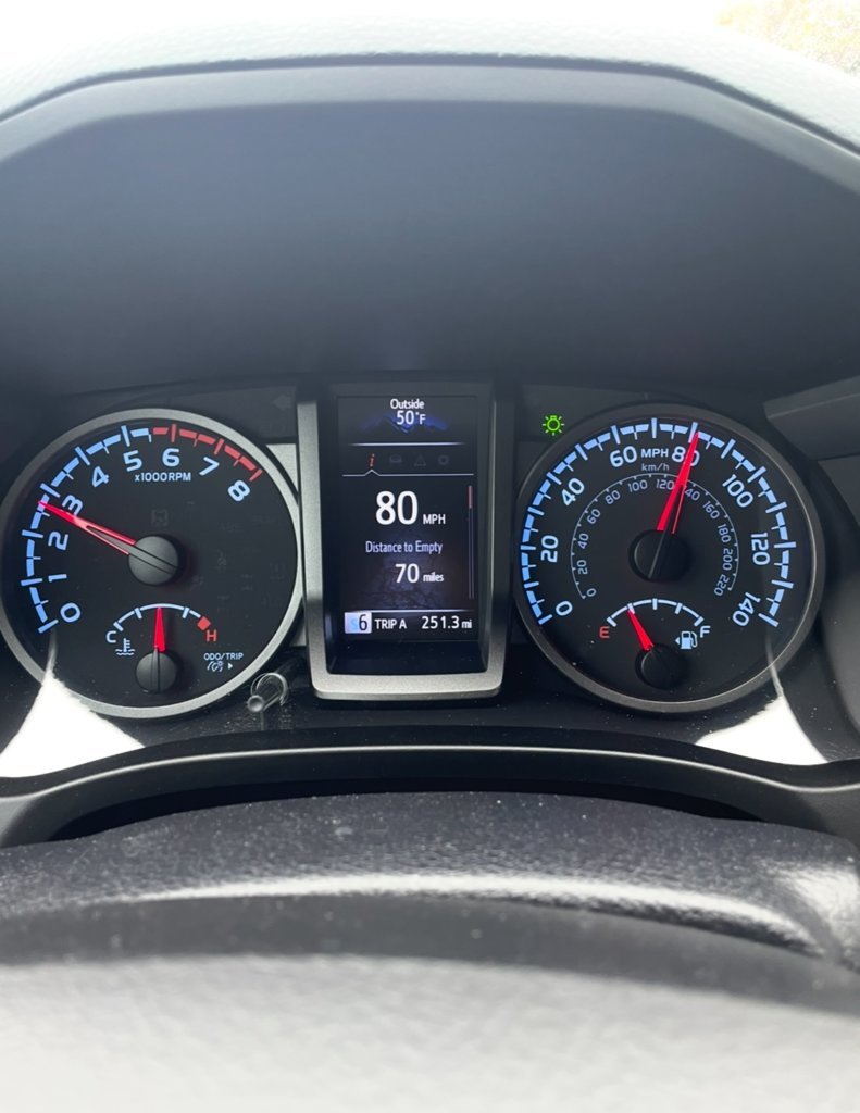

    I’m sure 6th gear is actually useful now that you have the leverage to turn that gear on anything other than a flat stretch of road. What are your RPM’s at when you’re in 6th around 75mph? Also, what size are your tires exactly? Thank you for chiming in.

    I can go up slight grades in 6th it’s still slow just more normal feeling slow. I had 265/75/16s and now I run 235/85/16s. The truck likes the same height thinner tire. Keep the weight down and the tire size minimal with the 4 cyl.
