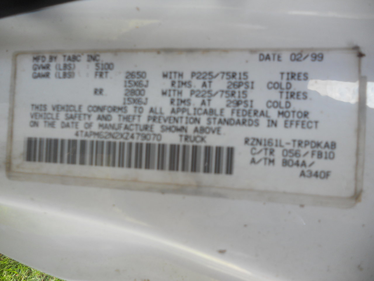

    1999 ext cab 2.7l , 4x4 manual hubs , auto, 106k miles, 245/75 r16 ( bone stock except for wheels ) no idea about rear gear ratio (how to read off sticker?)

    I have the same 99 2.7 and a auto. I got 19 on the highway and that was it. With the auto trans, they paired it with 4.56 gears for a little power. The manuals have various ratios. The code on the door will tell you.
    DSCN6910.jpg B04A 4.56 bottom right corner.
