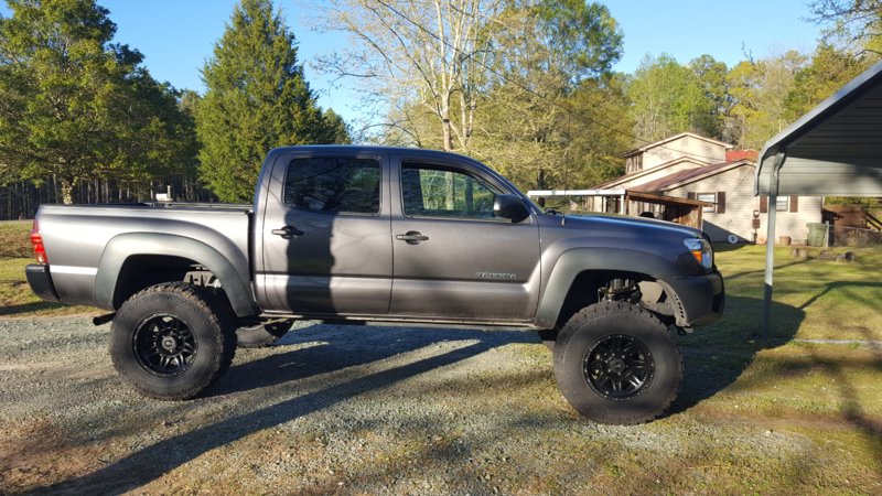

    yeah mine absolutely hates a hill especially just running the 4.10 gear lol You have a beautiful truck that's for sure. Love that body.
