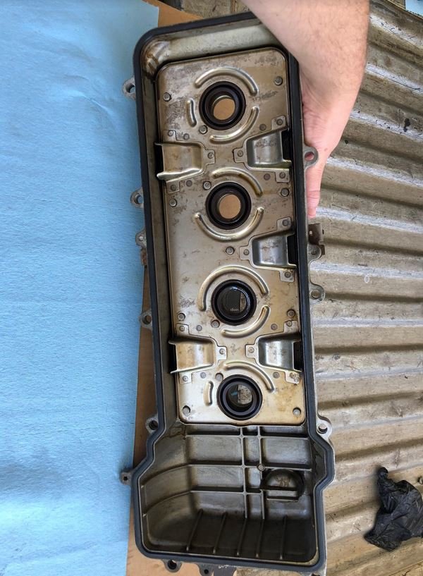

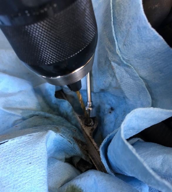

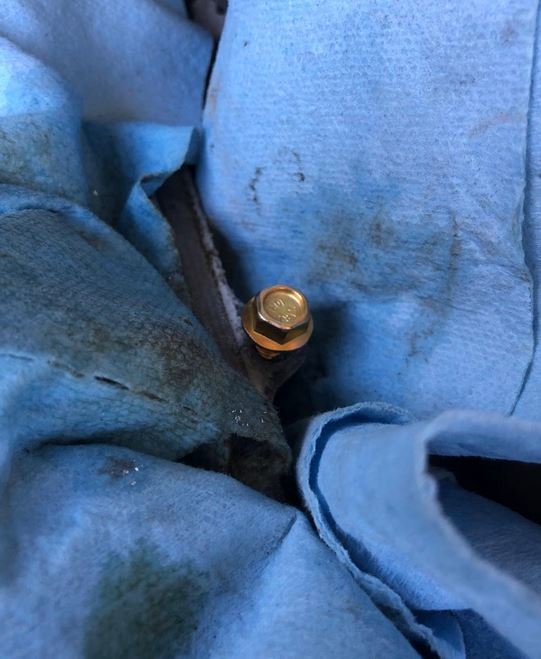

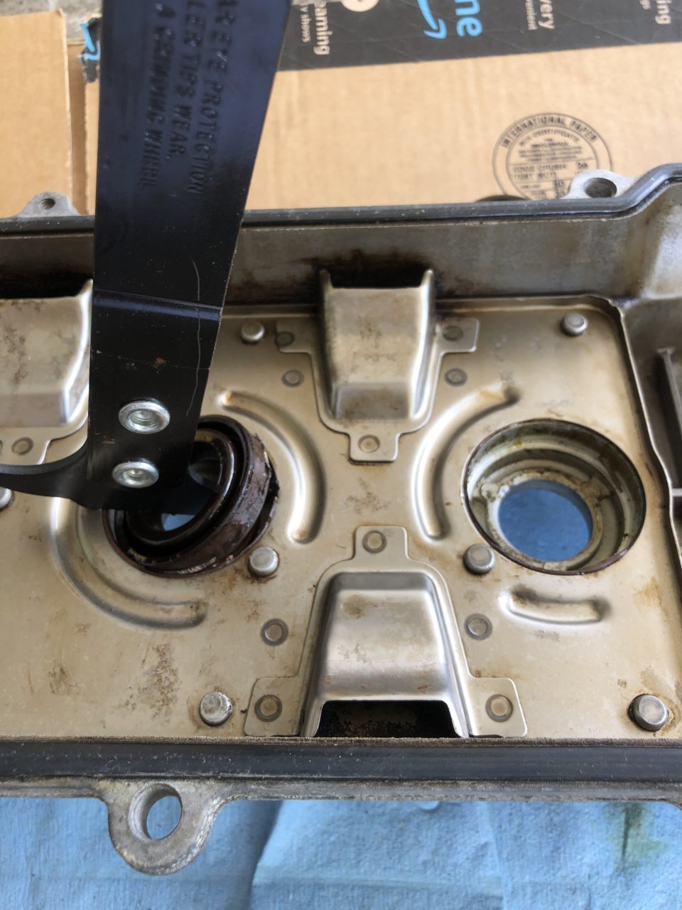

    I cleaned the valve cover, it was covered in black grime. It looks good now. I also fixed the stripped valve cover bolt. I drilled and tapped the original threads and replaced all bolts with flanged M6x1.0 bolts from Advance Auto parts. (I haven't installed them yet). If there's a problem with it later, I have a helicoil for backup. I have a new valve cover gasket, grommets, and spark plug tube grommets to install when done.

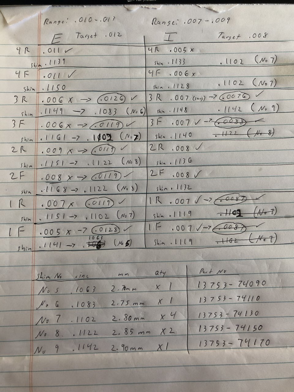

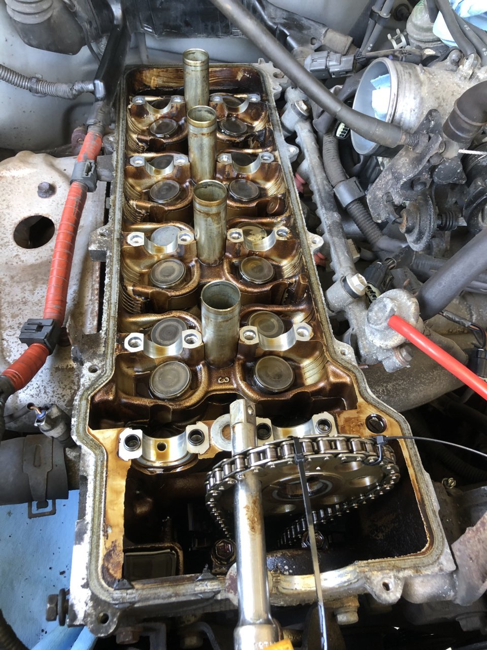

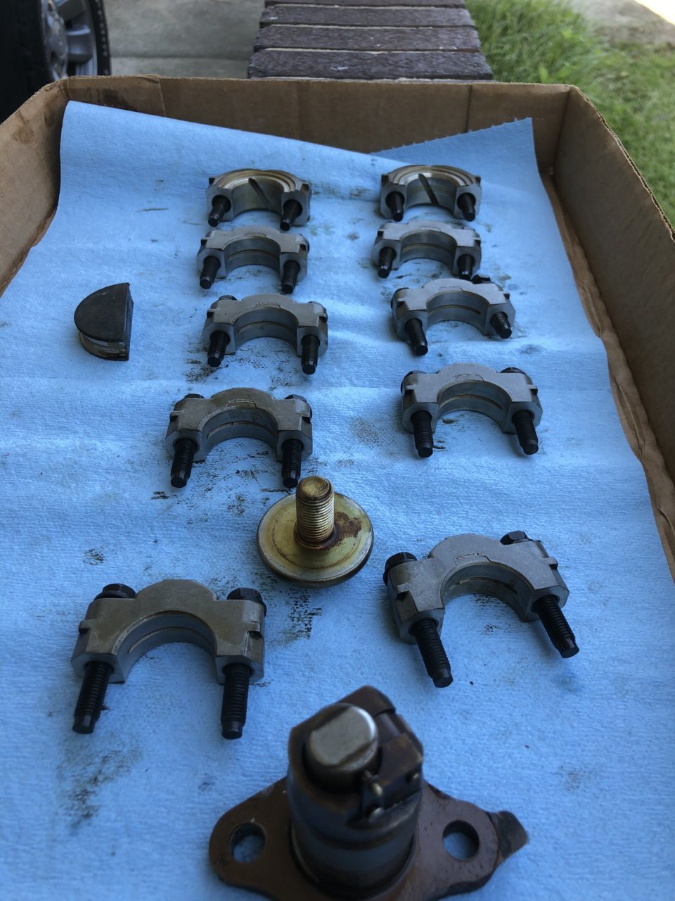

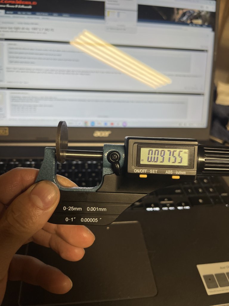

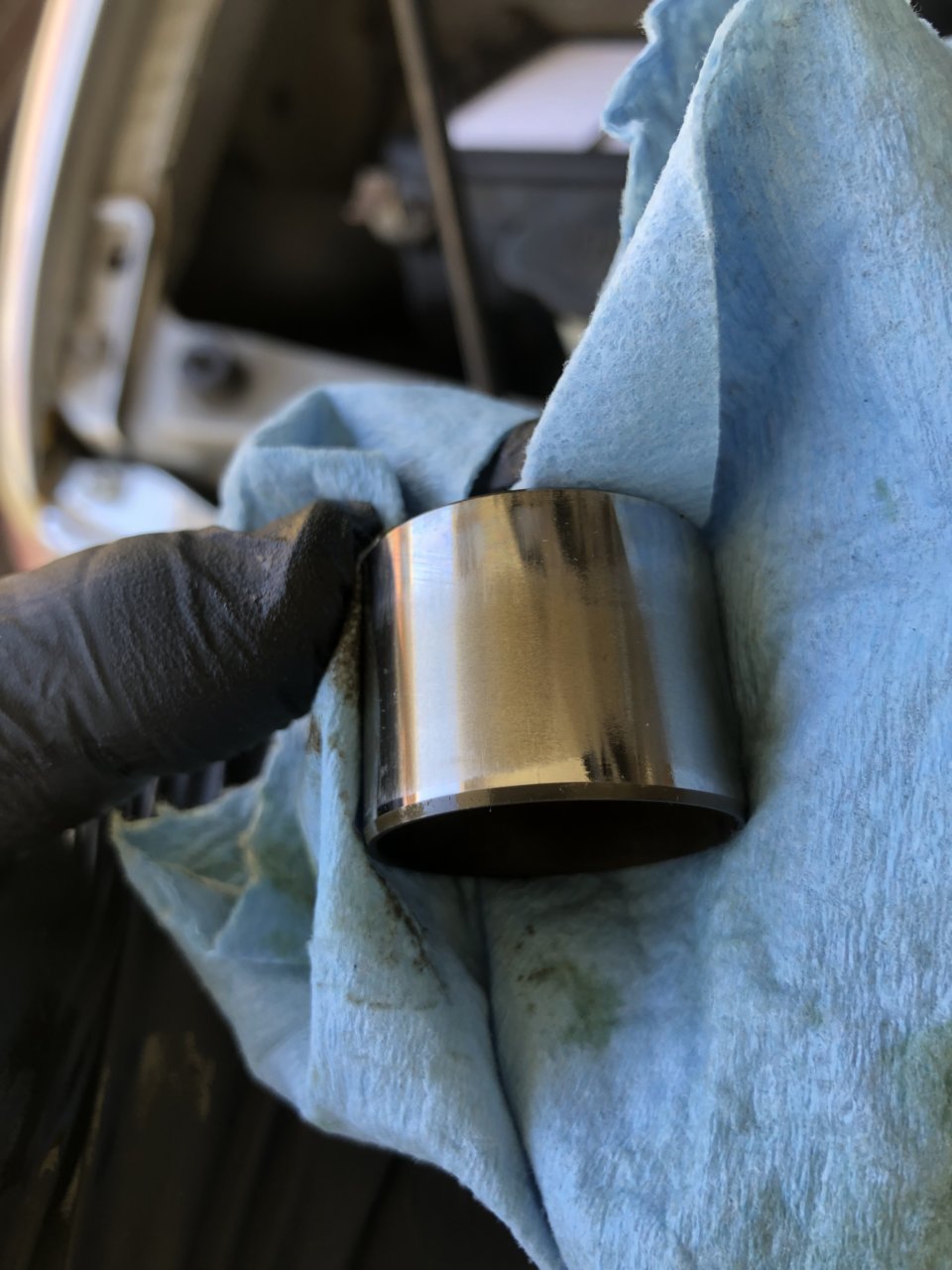

    Shim measurements:
    I finally got them all measured, took the cams out to make it easy. Good thing I did too cuz I found a shard of metal stuck on the side of one of the valve buckets. Byproduct of my drilling. I ran a magnet all through there and inspected every bucket. All buckets have a but of wear as pictured, but it doesn’t look bad to me. Then again what do I know?
    I need 9 new shims to bring them all back into spec. None of the old can be recycled, due to thicc-ness. I have the part numbers listed at the bottom of the sheet.
    Now where to get them the fastest? My local Toyota parts counter is closed for the day. They’ll probably have to order them too. Toyota parts deal has decent prices, but it took them two weeks to get some other parts for me before they could ship them, very slow. Any tips? (Yes I remember when everything took 6-8 weeks, but this is the 21st century now).
    I gave the bearing caps and other hardware a good wipe down from the grime. Timing sprocket bolt was tight, regular bar wouldn’t budge it. Had to use the long bar. Tensioner bolts looked rusty, but they weren’t stuck, came off easy. Brass punch got the half moon out.

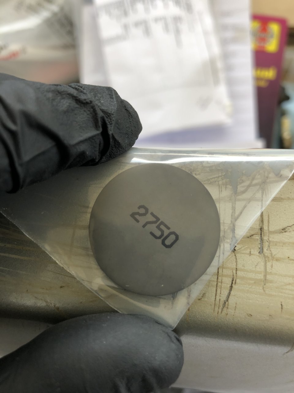

    Yep, the shims arrived at the dealership yesterday. Took off work early to go pick em up and get em installed. But other things hindered me from finishing the job, like my dog’s vet appointment, etc. I should have it finished later this afternoon with pics of the progress.
    det107 likes this.
  11. Jun 24, 2022 at 2:49 PM
    #31
    Jakuku Pahwheenis
    Jakuku Pahwheenis [OP] i provide useless forum contributions
    May 27, 2022
    #398083
    1,098
    J Phoenix
    South Carolina
    2003 Xtracab 2.7L 3RZ-FE 4x4 manual 245K+ miles

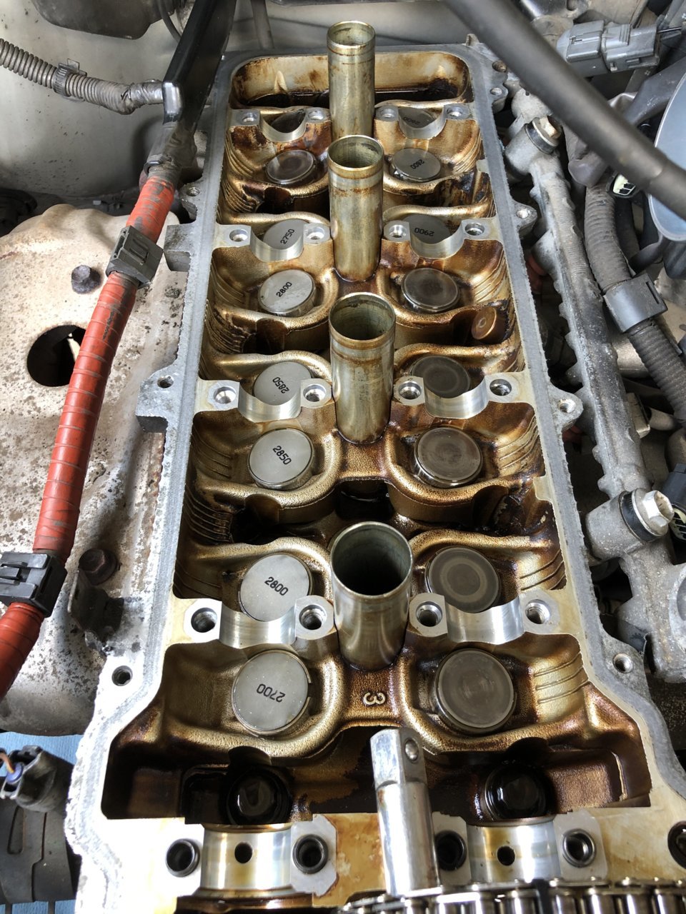

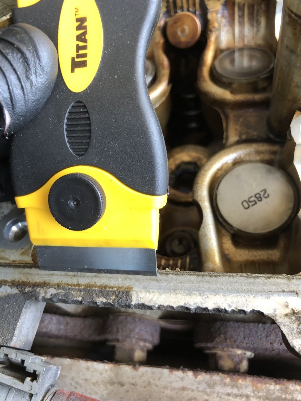

    New shims are installed. And all the valve clearances are back in spec. I scraped the edge of the head, replaced the valve cover gasket and tube grommets, and put it all back together with new valve cover bolts…well actually they’re just advance auto parts bolts of the same size as oem. I kinda like the silver and gold contrast though.
    While scraping, I dropped a razor blade down into the timing chain area. I was worried for a minute, but then I realized I have good oil in there which should flush out the bits when the chain grinds them up……I’m just kidding I fished it out with a magnet.
    Tomorrow, I’ll do another compression test and drive it around to see if the misfire still occurs.

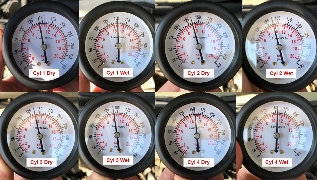

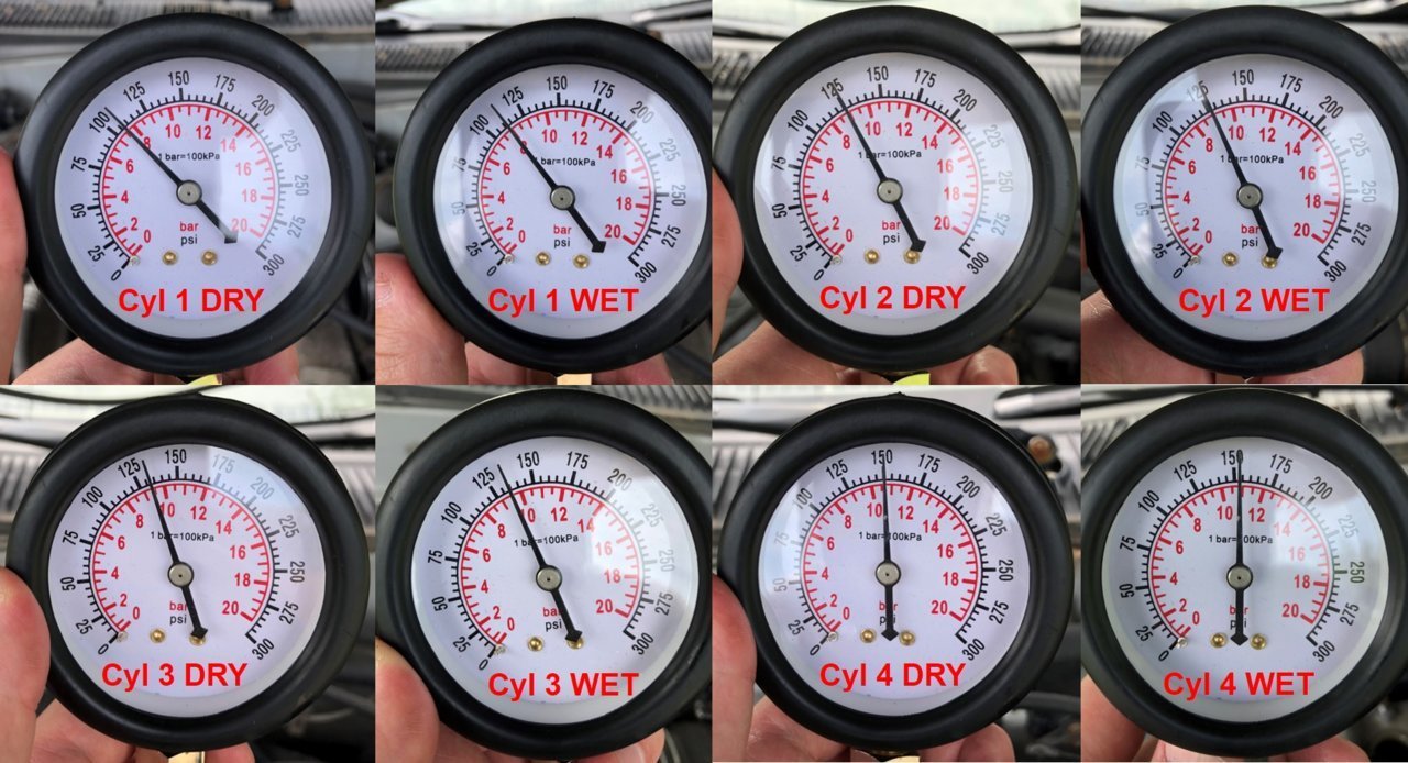

    Post valve adjustment compression test results:
    Cylinder 1 saw significant improvement. The exhaust valves were .003-.005 inches out of spec and I adjusted them to be on the loose side of the acceptable range at .012 inches. This resulted in a dry compression increase of 36 psi. Cylinder 1 compression was about 142 psi dry, 151 psi wet, a difference of approximately 9 psi.
    Cylinders 2 and 3 saw some improvement in compression with dry pressures at 134 and 136 psi respectively with only a 2-5 psi increase for the wet tests. Cylinder 2 improvement equated to a 10 psi increase from the pre-valve adjustment test. Cylinder 3 compression increased by only about 4-5 psi.
    Cylinder 4 saw little change with both dry and wet tests at 155 psi. This equates to a variable difference of about 2-5 psi from the pre-valve adjustment tests.
    For comparison, here are both the pre-valve adjustment and post valve adjustment compression gauge readings
    Initial compression test:
    Post-valve adjustment compression test:
    Leak-down etc:
    The good news is that all valve clearances and cylinder compressions are within factory spec. The wierd news is the cylinders are still a bit varied from one another. Cylinder 1 is closer to Cyl 4 and honestly doesn't look that bad to me. Cylinders 2 and 3 are now the lowest, but still within spec. I did another leak-down test and was left just a bit more confussed than I was the first time. They all seem to be leaking a bit from everywhere, but I don't know the volume of leakage, bc I'm a cheapskate who buys crappy chinese gauges from Amazon. I will probably need a valve job and piston ring job at some point in the future, which isn't surprising based on the age and mileage of this vehicle, especially since it's maintenance history is sketchy. I am going to plan for that, but if this solves the intermittent misfire for the time being, I'm going to focus now on the rusted frame repair and worry about engine overhauls afterward. After watching lots of YouTube, I will probably start by removing the head myself, doing my own valve inspection and lapping job, and see if the various factors are within spec or not. If not, have a machine shop reseat and replace the valves.

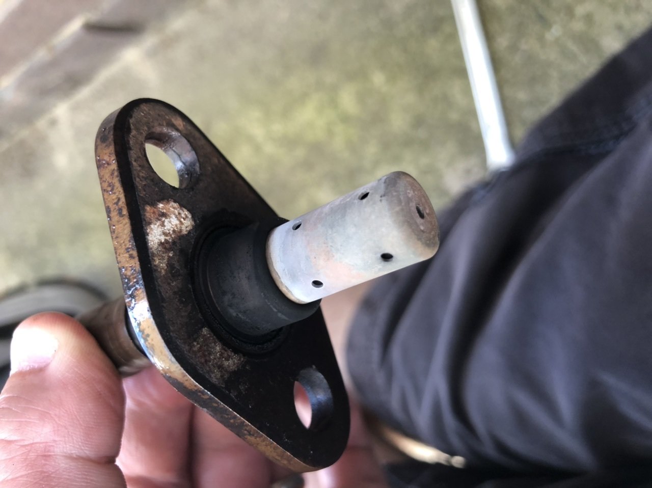

    I bought a scanguage and it did communicate with my ECU. However, it only had a P0135 code stored in there for the upstream O2 sensor. No codes were stored for a misfiring cylinder. Hopefully the misfire doesn't come back. Now, what to do about the P0135?

    Here’s the old upstream O2 sensor
