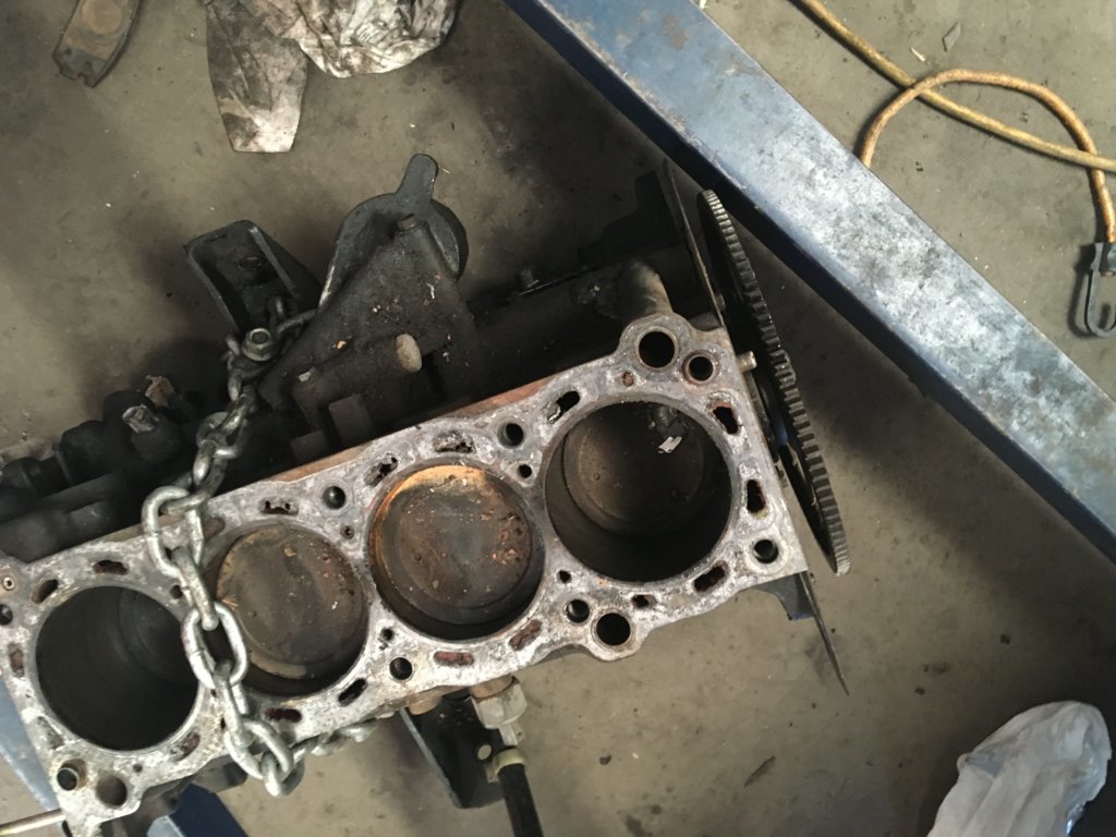

    it might......the ecm is looking for the egr to kick in inert gas
    also running without egr at hwy speeds you risk over heading the head
    right at cylinder 2 and 3 on the exhaust side
    you'll see
    unless you get rid of the cat too......the cat is the problem
    crazy shit.....cant make this stuff up
    I would love to drive around and watch you're fuel trims just to see what happens when there is no inert gas
    I might go disable mine and set what happens in couple weeks

    See....told you so

    That's interesting I've never heard of that. I'll definitely look into that. I haven't noticed any difference in the delete that would make it worthwhile anyways.
