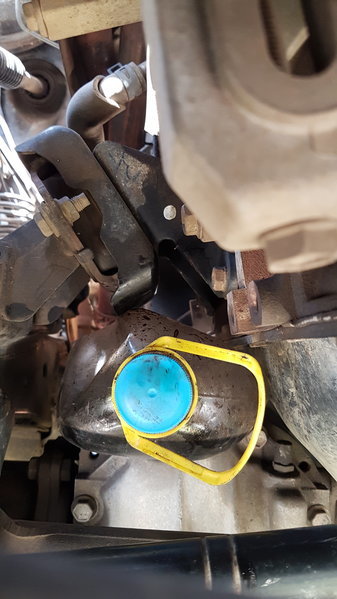

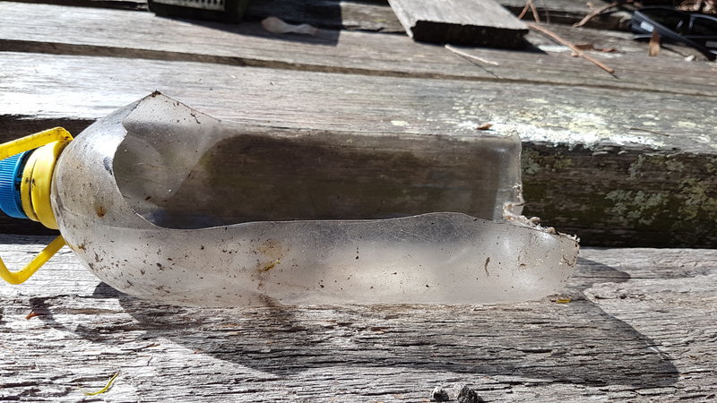

    Not sure if the photos have attached or are a good example of what I do but I did a oil change on weekend and didn't spill any i do remove skid/ bash plate to get better access to oil filter 20161224_095148.jpg 20161224_091959.jpg

    how do you get your hands in there to twist off the filter with the bottle in the way?

    This sounds promising - how about Pics ?? Thanks.
