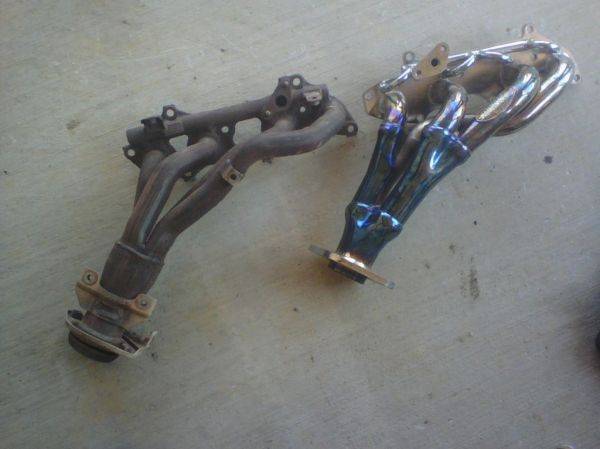

    here is a side by side i took while installing mine today
