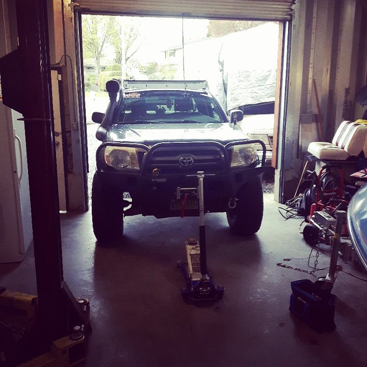

    Hey boys I need to know the stock hub to fender measurement for 2ND Gen I need to compare my current amount of lift to oem the Google God isn't helping. I'm on my 3rd try at adjusting my Frankenstein icon coilovers sitting at 24.5" currently icon 2.5 with king 14"700 springs

    Wish I could help. Never measured before I put my lift on. She's sagged quite a bit now, but I know it's still up fron stock. Got to be someone in this section that still has a stock 4 cyl and can pull a measurement for you.
    ETA: truck looks nice. I've been in a dusty environment lately and have been thinking about a snorkel. What's yours and how's the fitment? Pain to install?

    I'm in the same boat just trying to compare with the new setup. I have ano airflow snorkel. It's great install is tedious but anytime you drill and make huge holes in your truck you measure 800 times, fits like a glove

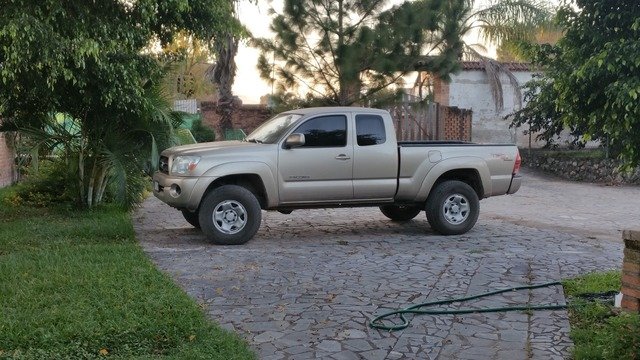

    Found my stock (pre-lift) hub-to-fender numbers for my 05 that might help :)
    FD___FP
    19.25 20.25
    RD___RP
    22.25 23.62

    OK cool ya I'm at 24.5 passenger and 25 driver the rear has like 5" of lift lol
