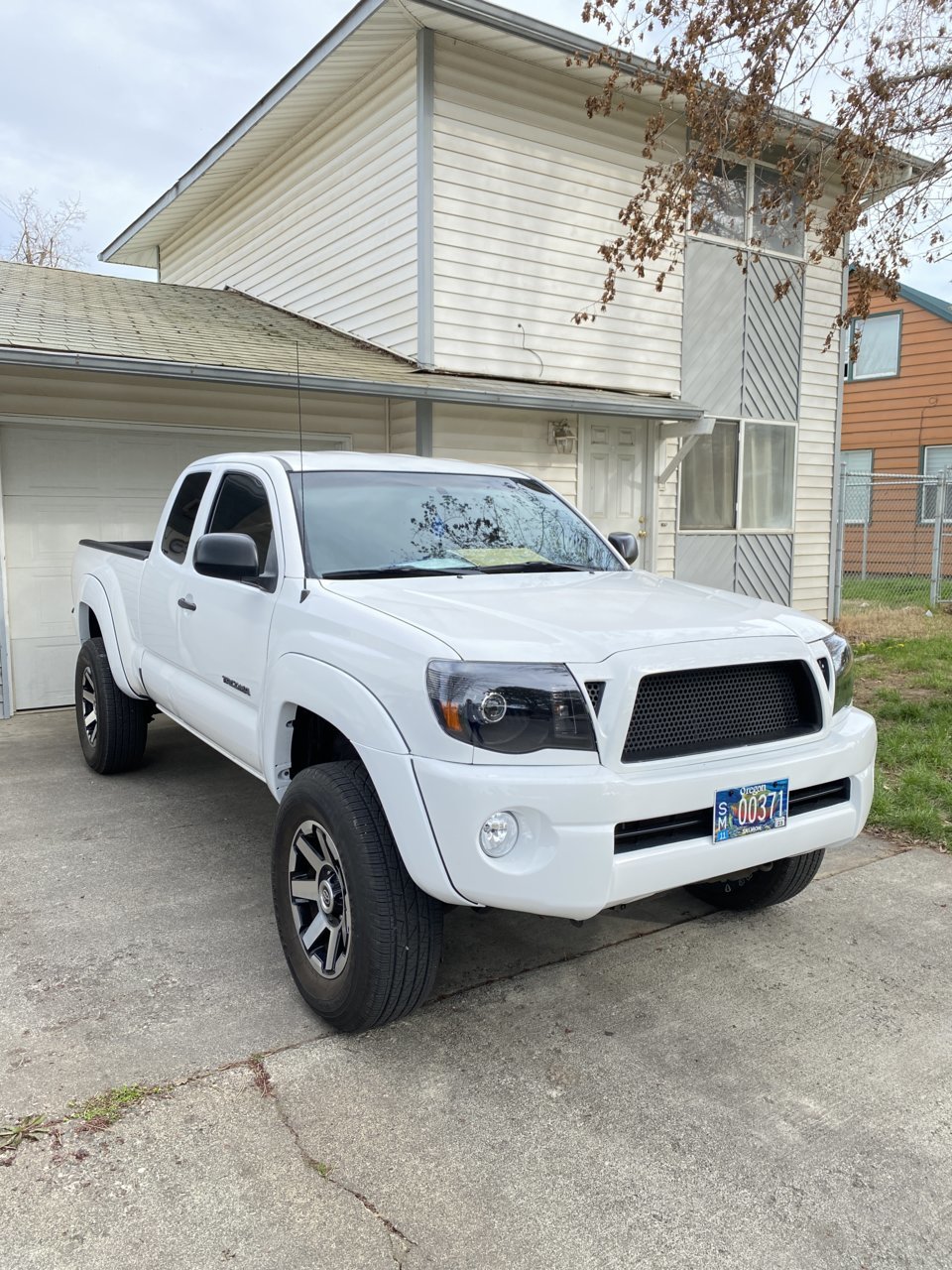

    Lalo
    06 4x4 2.7 5speed Access Cab
    Bilstein adjustable shocks 1.25” spidertrax wheel spacers Grille Mod Projector Headlights

    Great looking truck man!!!

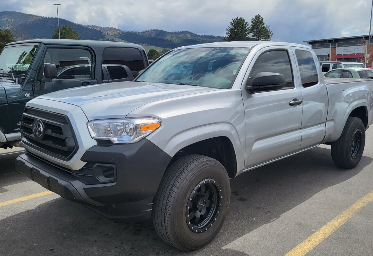

    I just picked this up and added a tonneau cover and wheels so far. I'm really happy with it. 20220509_141041-2.jpg

    Welcome aboard, and nice truck!

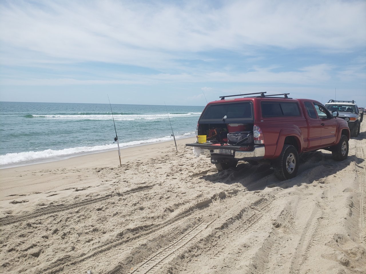

    I think the Access Cab looks good with a cap. I don't see too many of them.
  19. May 30, 2022 at 1:45 PM
    #2019
    amRRussel
    amRRussel A guy with a truck
    Feb 12, 2016
    #177946
    588
    Andrew
    2011 Access 4banger 4x4
    Driver Mod
    I bought it with the cap, as I was looking for that for camping with the wife. It has worked excellent. I take it off from time to time for truck hauling duties and think it looks good without it, but then start missing the look and when it goes back on I think she looks complete again. :D
