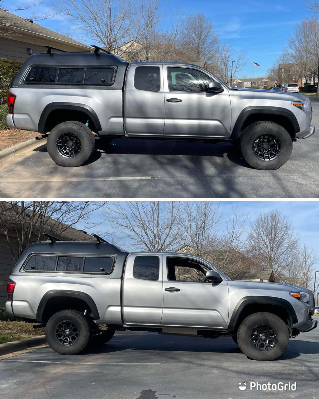

    I went with the 2020 trd replicas 16” I weighed all the wheels the sr’s were 23.6-.7 and the FN’s were 17.4-.5 a 6lb difference is felt for sure especially on the 2.7 I doubt you would feel as much on the 3.5. Top are the new FN wheels the bottom is the factory sr wheels the truck came with. The cooper 265/75/16 AT’S are 41lbs so 58.5lbs per corner now with the bigger AT’S and FN wheels over 54.5 lbs with the stock wheels and 245/75/16 firestones all seasons

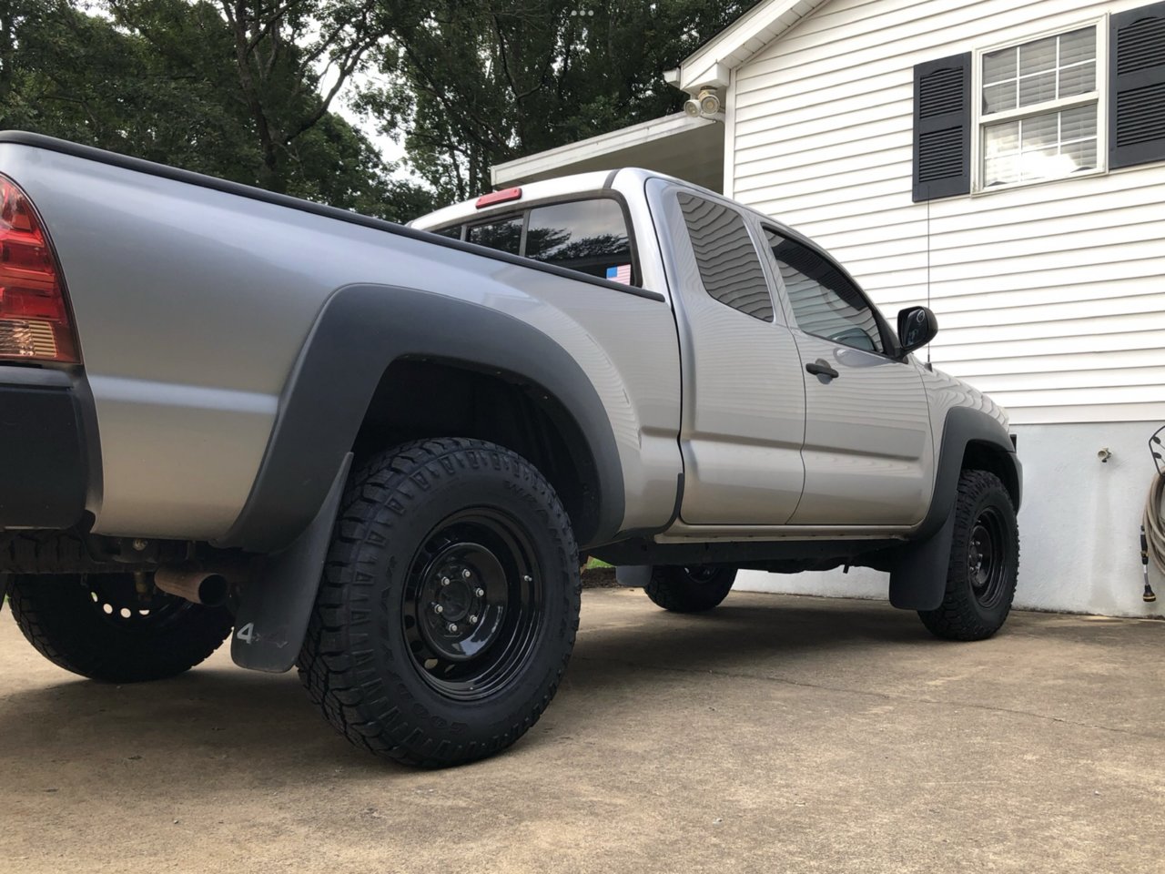

    Looks great man, you ever think about some white letter tires? Might look pretty good.
    Those wheels are nice and light also, man you have my brain thinking….
    My 17” FJ steelies are heavy!!! Argh!!! But look great, lol… Can’t have it all can we!

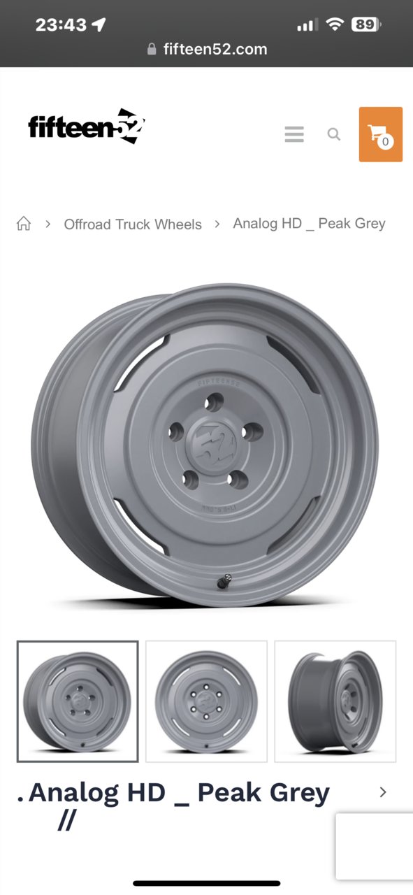

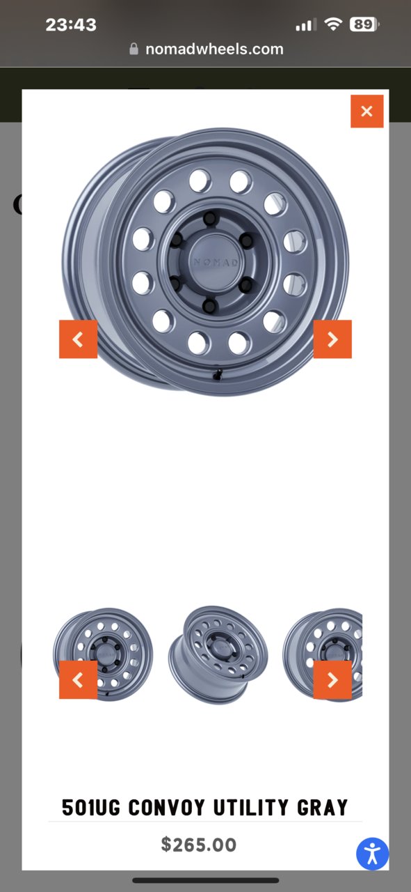

    Well there are Nomad and Fifteen52
    with kind of lookalike to older steel designs.
    Weight is close to a factory wheel though.
    I love the Nomad,

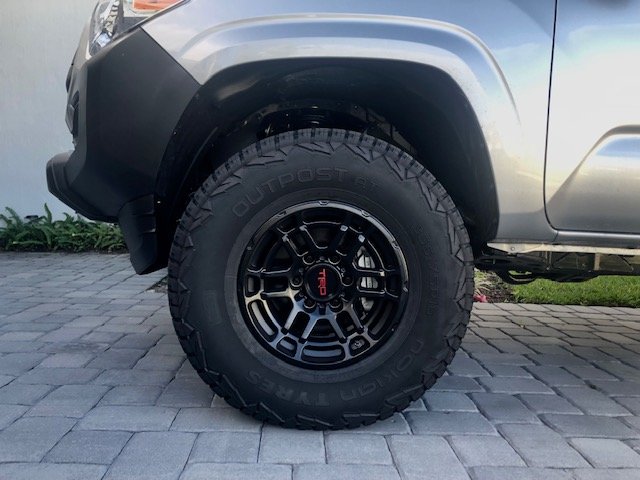

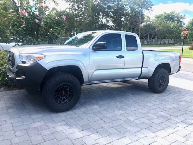

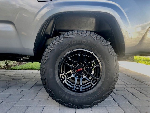

    Swapped my Sr steelies for TRD flow forged clones from FSW (lost 12 lbs per corner there) and added Nokian Outpost AT 265/75r16 116T (43lbs. each, picked up 12 lbs over stock 245s) corner wheel weights are an exact match to stock steelies and 245s (about 63lbs), but heavier tires (weight farther from center) I did notice slight difference when accelerating from a stop and lost about 1mpg. Added Bilstein 5100s (all 4 corners) 4th notch - 1.5inch lift/level in the front, rear stock height. The ride with bigger tires is now night and day smoother and more planted than stock Hitachi shocks.

    Those 501’s are sharp but 25lbs if they were around 20 I would have jumped on them. I live in NC too Charlotte area and you know it’s a hilly state my truck thanks me by shedding a few lbs per corner plus after selling the old sr wheels I only have about 400 in the swap after mounting.

    Looks great I looked at those as well a little nicer looking but I think they were 20.5lbs a wheel which is why I went with the 2020 reps. You have a 2.7? I have icon stage 2 leaf pack and 5125s in the rear I wanted to pick the front up with 5100s was thinking notch 2 still want a rake. Can you take a measurement from center of wheel to fender in the front. You don’t see a lot of info on 5100s on the 2.7

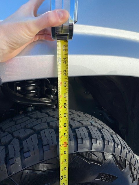

    Yep FSW clones are 20.5lbs. 2020 reps look great on your rig. yes, 2023 2.7. I think the wifey and I measured correctly, at 22.5inch (parked on driveway with slight incline). I still have about a 1/4 inch rake in the rear, the 265s also gave about another .5inch all around above the 245s.

    I like the trail wheels they look great. Appreciate taking the measurements, the rear I’m at 24 1/4 with the icon leafs and 5125 bilsteins and 21 1/8 in the front all stock. I am on 265/75s as well and have fender flares which I’m sure changes the measurement a hair. That would make sense you said you did the 4th notch? so pretty close to that 1.5 lift. I always saw people say on the 2.7 add about 1/2” to 5100s height measurements but it looks pretty close to advertised

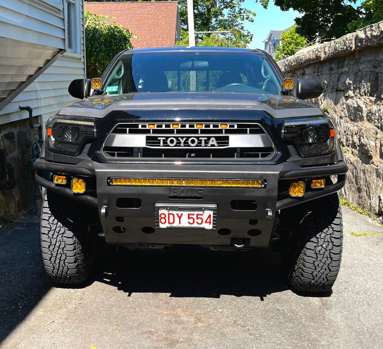

    Does anyone have photos of 885 OME coils on Bilstein 5100's? I'm going to be ordering coils and UCA's very soon. Right now I'm on stock coils set at the 3rd notch getting 21 3/8's even in the front. This is with a BAMF hybrid bumper.

    Where did you get the black grill surround on your truck? I’ve got a black truck with an mgm grill surround wanted to get a black one

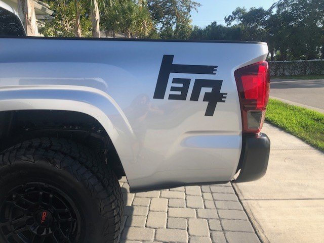

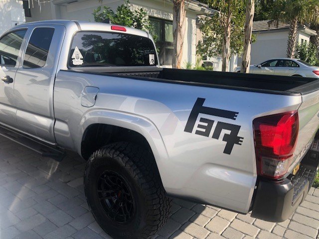

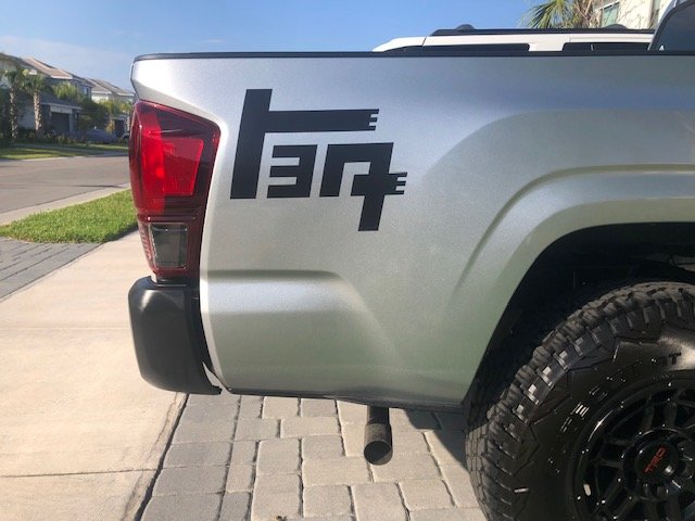

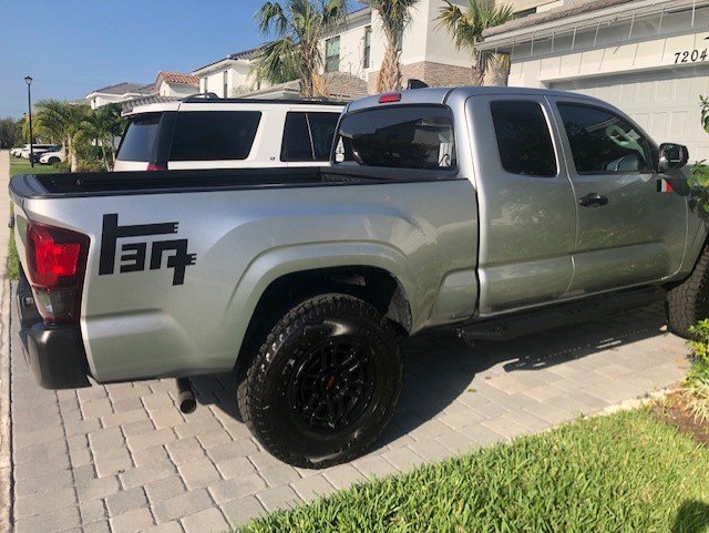

    "TEQ" vinyl bed decals installed.

    Bro those look so good, they would look great on my AC!
    Got a link?
