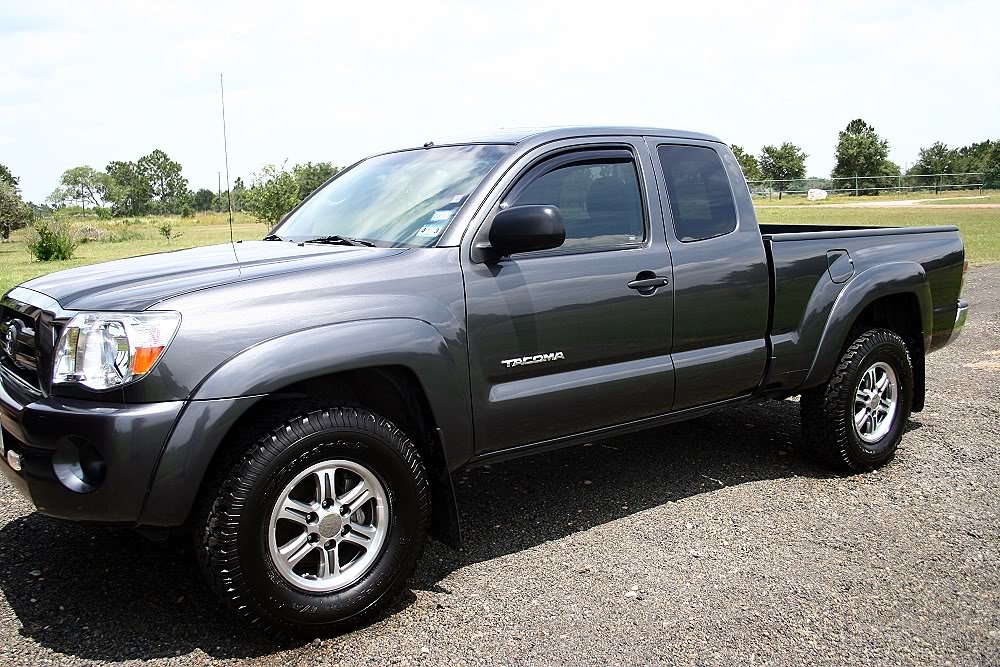

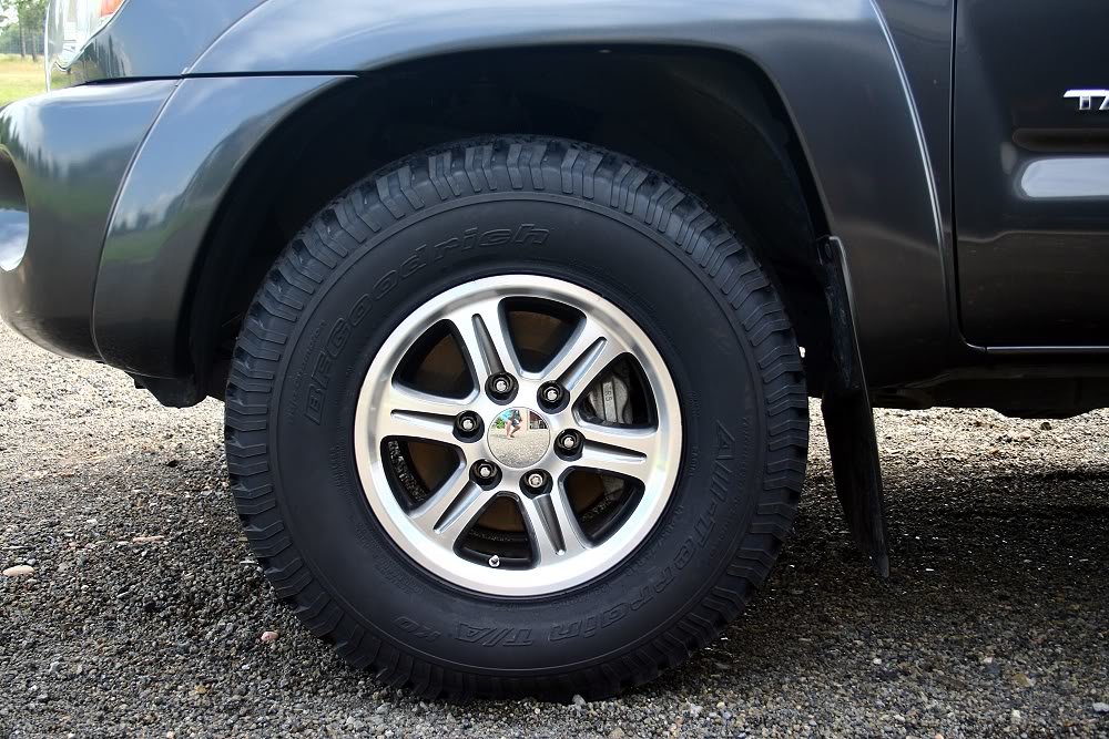

    Yep I swapped from the stock Dunflops P245/75/16's to BFG All Terrains LT265/75/16's and went from averaging 26mpg to 23.5 mpgs. Also doing this made my speedo correct, from the factory it was 2 mph off.

    Looks good. Are you figuring MPGs from actual or your odometer that is now off? With my 255/85/16 BFG KM2s I travel 10% more miles than than odometer reads.

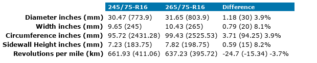

    My speedo is now correct as far as actual mph. My odometer is off by 3.7% - difference in the two tires. At 10,000 miles my odometer actually reads 9,600. I have an ultra gauge and have done the distance calibration for the tires as well as the fuel calibration. I use the distance trip on the ultra gauge which is correct instead of my odometer. My ultra gauge is accurate to the .1 mpg :D

    why would the speedometer now be correct and the odo off?they read off the same sensor.id think the odo is now correct,just like the speedo.i put 265/75's and my speedo shows correct by my gps.

    They do get the info from the same place.
    With stock size tires (245/75 or 265/70) speedo reads high (more MPH than actual) but odo reads correct.
    If you bump to 265/75s speedo is now corect but odo reads low (less miles than actualy traveled).
    If you go above 265/75 speedo & odo both read low.
    With my 255/85/16s when the speedo says 70 I'm doing 75 and my odo says I traveled 10% less miles than I did.
    Next time you fill up the tank reset the trip odo & the trip info on your GPS, then check them both when you fill up again.
