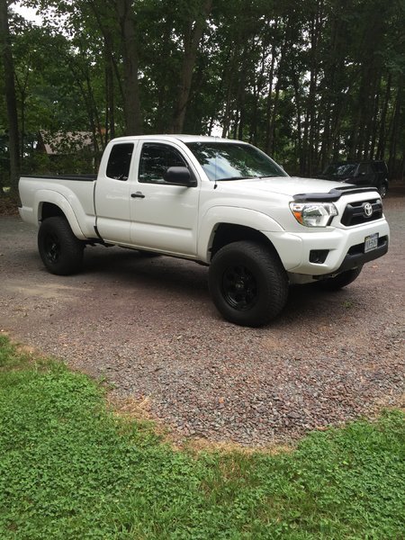

    2013 ac i removed the spacer lift in the front and installed 5100's with eibach 112620 620lb springs set the billies at .85 and got 2.5" of lift. removed the lift block from the rear and installed a wheelers 3 leaf aal with extended rough country shocks (they came with the original ift) still have to install the extended brake lines and have a set of front superbumps coming. it's getting there slowly. wheels are 17x9 4.5bs and -12 offset with 285/70/17 kumho roadventures. truck rides and handles great and i honestly didn't notice much loss in power or mpg with the 285's. damn these trucks are great

    thanks but they're off the truck now for sale looked great just changing some things around

    How wide where they? How did the truck feel and act with the wider tire?

    they're 17x9's with 285/70'17 p rated tires they're actually about 5 pounds lighter per wheel and tire than the stock steel wheels with e rated 245's they ride fantastic and handled really well i actually never noticed any power loss or mpg with them

    Sorry Last question what manufacture of the tire? Any other upgrades?

    kumho roadventure tires. as far as upgrades or mods if reffering to the truck fornt suspension bilstein 5100's set at .85 with eibach coils and wheelers superbumps. rear suspension wheelers 3 leaf aal with extended shocks and extended brake lines. rear diff greather relocate to bed cubby, plasti dipped rear bumper, grill surround, and grill emblem.husky floor liners, avs bug guard, and avs window shades thats about it not really much i've only had it since last december so i've got plenty i'd like to do just need the funding to do it. edit also removed the mud flaps and trimmed the bottom corner of the front flares

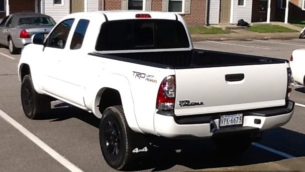

    you've got a great looking truck and this place is great for info. sometimes you just have to weed through the bs to get it here's what it looks like now not very pretty

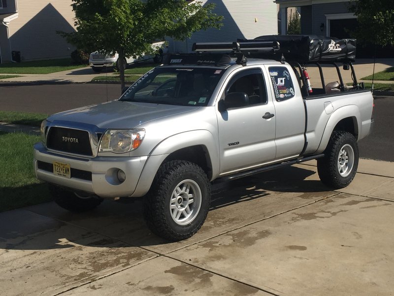

    Forgot to add my picture to this thread after I did the wheels and tires!

    Looks GREAT ! what wheels/tires are those (and size)

    255/80/17 cooper doscoverer st maxx with 17 inch SCS Stealth 6 wheels in matte silver

    51 lbs per tire... The wheels are really light... Don't know the official weight but I can weigh it when I get home
