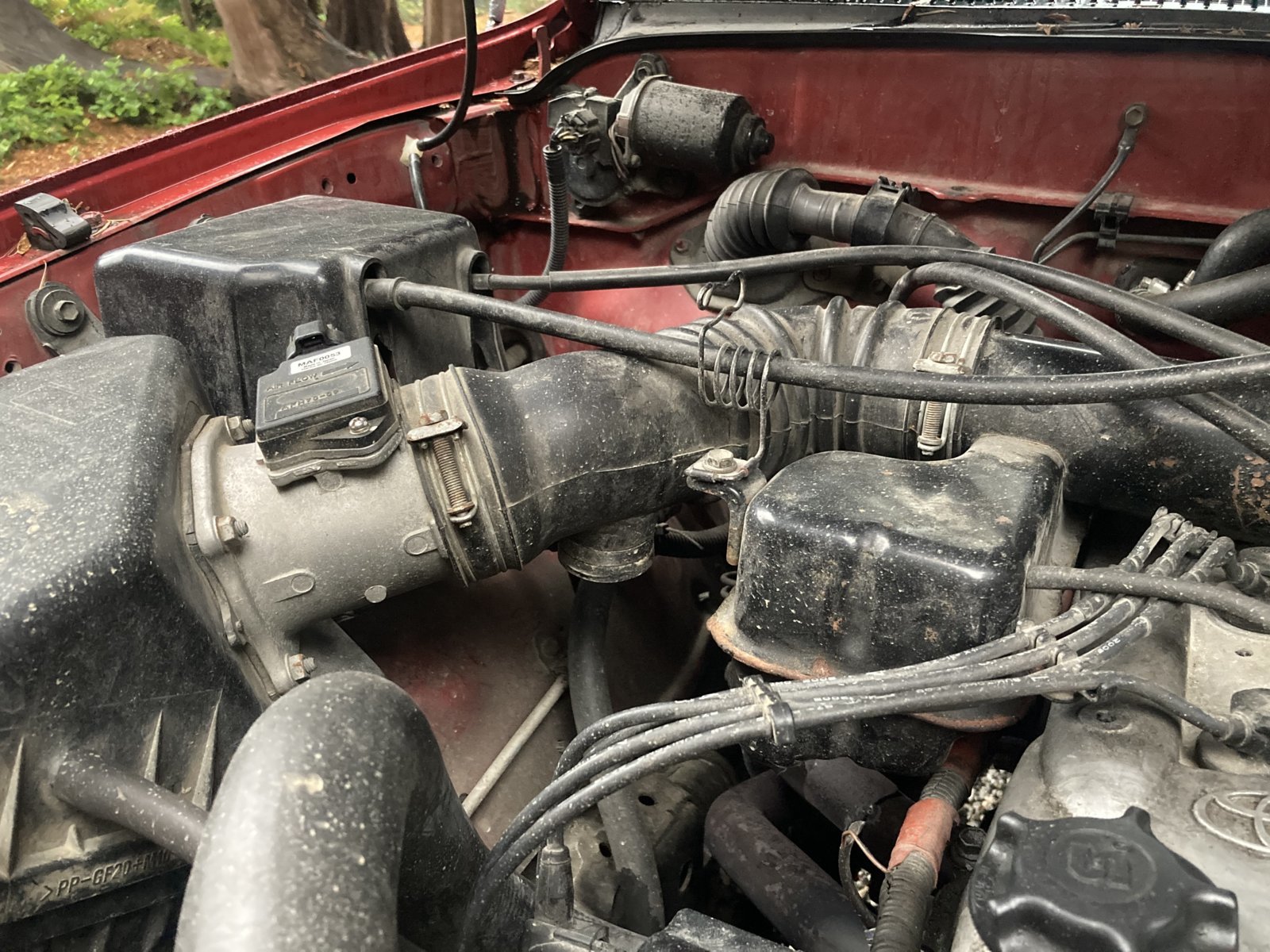

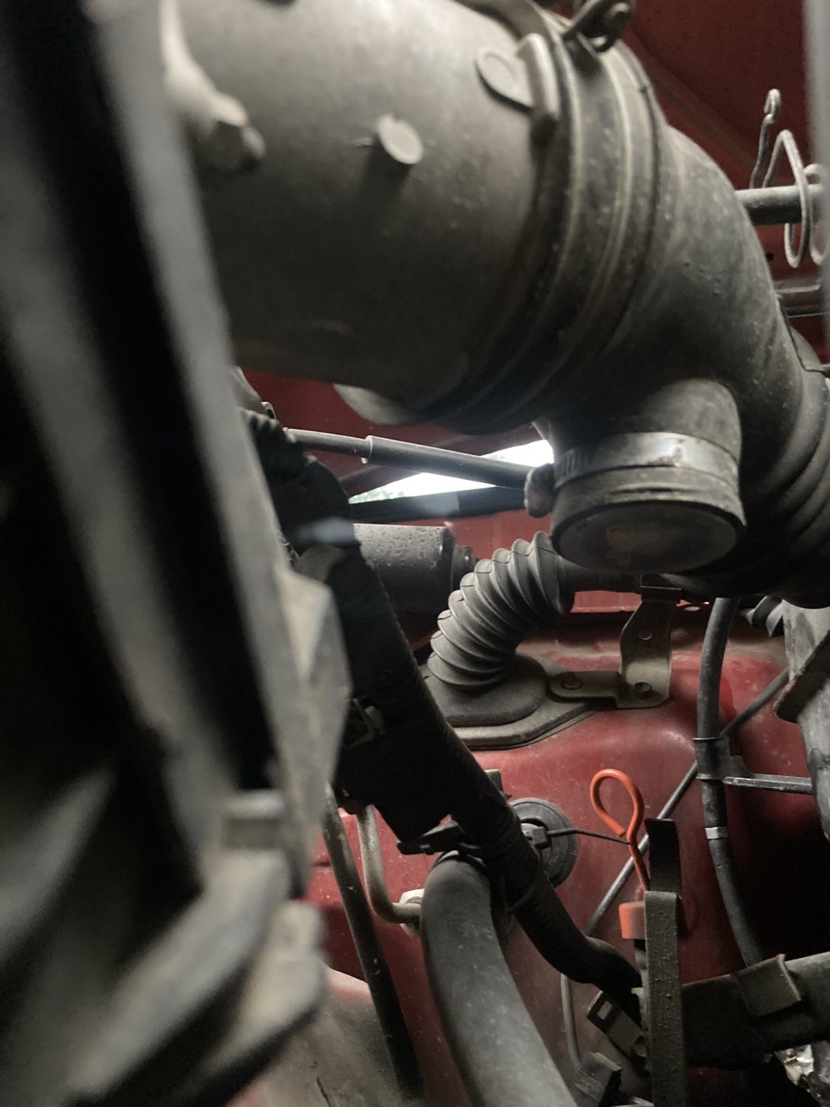

    Hello. Truck is a 1996 2.7l.
    Just wondering if anyone has deleted the air intake resonator, and if they had any issues after doing so.
    Mine has a hole in it, deleting would be the easiest fix as they aren't made anymore. Aftermarket intakes don't have a resonator either.

    cold air intakes done away with them.....
    quiets down the engine a small amount...
    zero performance change.....keeping it is just one more place of possible failure.....
    unless it was leaking....then you'll have a big improvement...

    Ok thanks. Yeah I saw that some aftermarket intakes had deleted it.
    It did indeed have a hole about the size of a quarter in it.
    Deleted it yesterday, no issues so far.

    OP..could you post a pix?
    Interested how it looks
    Thanks
    Btw my 96 2.4L ‘box’ appears to be one piece. I have taken mine off 4 times
    Cross tube welded to box
  5. Oct 21, 2023 at 9:35 PM

    Be careful about patches on the intake tube....reg duct tape just cooks to death...
    ...and then you get an intake leak.......
    needs to be something good .....like aluminum plenum tape...

    Actually thats the moisture catch can he deleted.
    If you do that .....might want to have a drain hole in filter box on far side of the filter....just in case.
    Water can get into that box.
