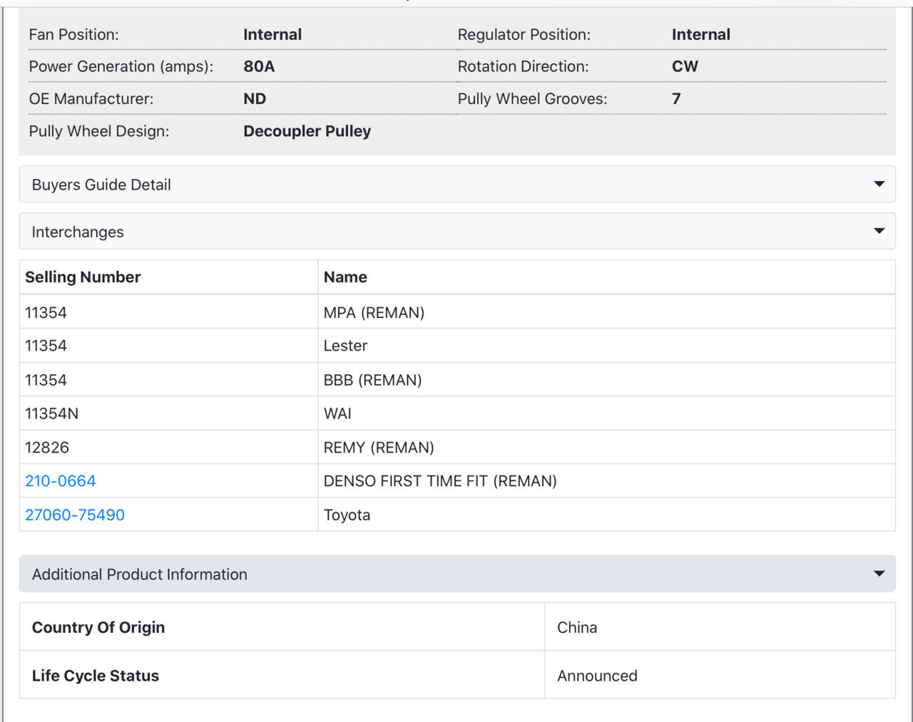

    My understanding is one for 3/2009 - 10/2009
    The other is for 11/2009 - Newer
    If I were really concerned about it, I probably look on the door sticker and seen when my truck was manufactured and get the correct one.
    Me, being who I am, I’d get what ever one Toyota has in stock, and stick it on.
    They both seem to be 80A/12v.
    My research shows the TYC is manufactured in China.
    With all the stories of faulty “New” and “Reman”.
    I’d hesitate to buy anything, from anyone, other than OEM or OEM Reman.
    Somethings are fine to go “cheap” on, but not parts that are critical to keep me “moving”
    I went to the TYC site and found this

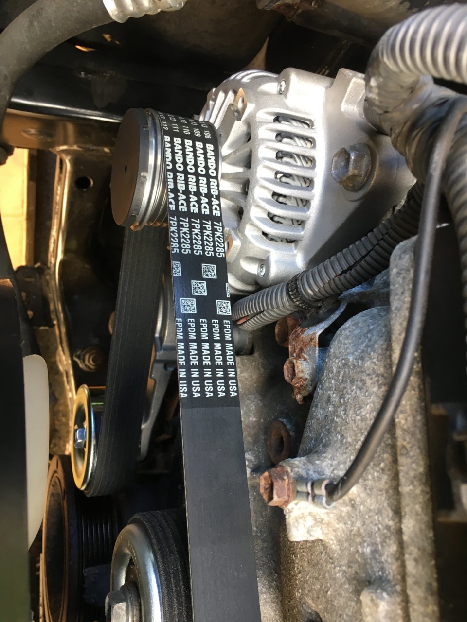

    UPDATE....
    So I installed the TYC alternator (2-11354) and it fit perfectly. It's a nice unit, finish seems top-notch. I also installed a Litens belt tensioner (999308A), a Koyo upper idler pulley (PU107029RMXY) and a Bando belt (7PK2285). I'm going to need an OEM Toyota replacement lower idler pulley (88440-25070, about $50) as the Koyo I had ready to go in wouldn't fit; the factory attachment bolt is too thick.
    How about the contrast between the new frame and the old engine block!
