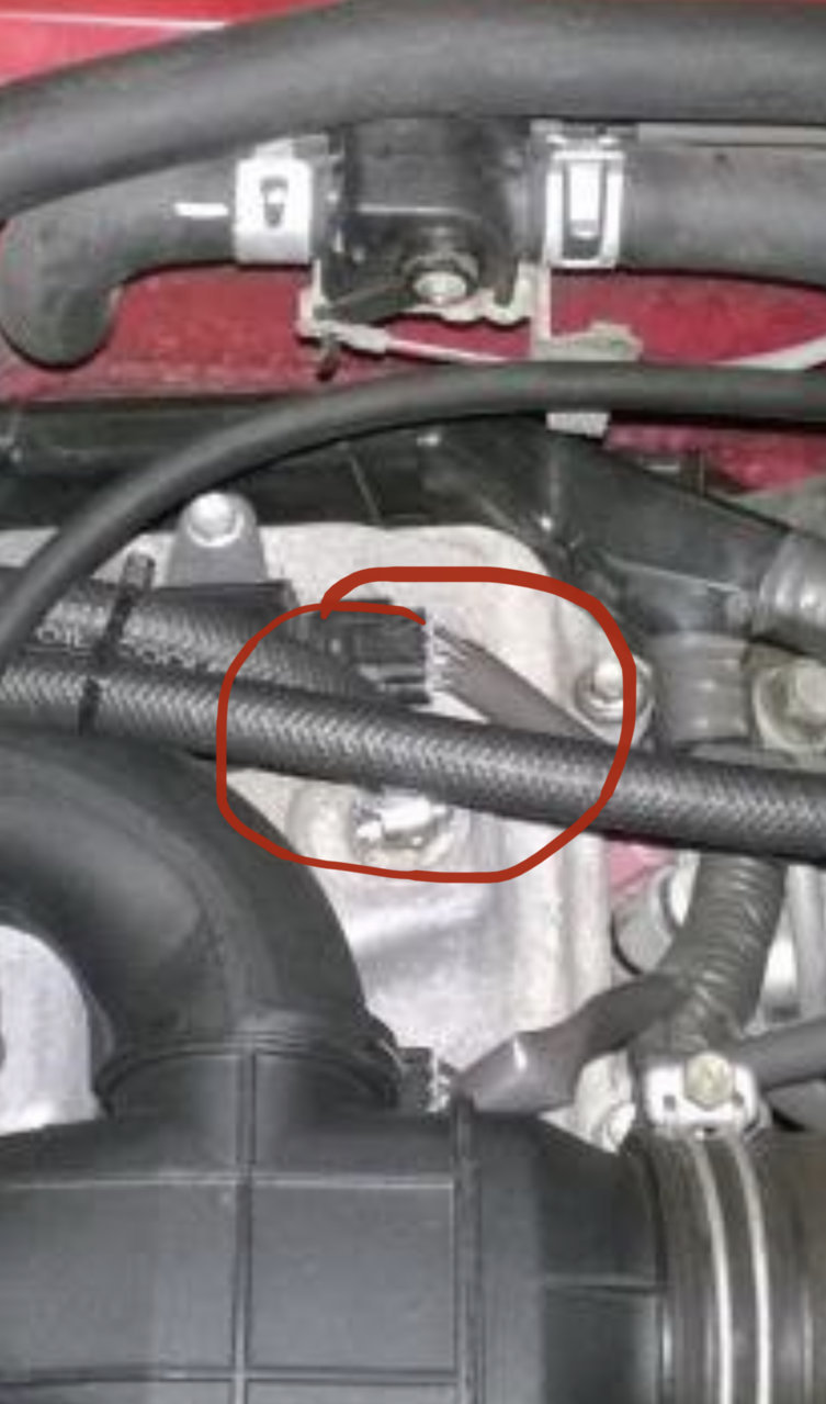

    Can you post a closer picture of this area please? I’m about to do the same setup and this was the only tie in I wasn’t sure on
