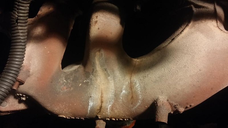

    712
    Missouri
    2016 Tacoma TRD Off Road (Manual), 2004 4RUNNER V6 4x4
    Ok. I know there is probably an existing thread about this but you guys have been so helpful I wanted to run it by you first.
    I decided to take the heat shield off of my exhaust manifold while I was working on my truck. It has been rattling some and I wanted to see why. It turns out there are two hairline cracks in my exhaust manifold. They look worse than they are because they got some oil on them.
    Is this a problem? Will it cause problems? Is it worth fixing? Is it as easy to fix as just unbolting this one and bolting on a good junk yard version?
  16. Nov 24, 2014 at 3:44 PM
    #76
    keakar
    keakar Well-Known Member
    Oct 2, 2014
    #139537
    5,258
    karl
    louisiana
    2006 4runner sport 4.7L V8 (white)
    used to have - 99 2.4L I4 5 lug & 04 prerunner v6
    yep that will mess with your engine sensors but its really easy to fix and the best way is to buy the stock header conversion for it. its made of tubed steel so it never cracks and its a one time permanent fix. replacement cast iron headers always crack after a couple years and you will be facing this again. its also made of much thicker tubing and heavier gage steel then aftermarket headers and the stock headers are fully legal and use stock heat shields unlike most aftermarket headers. (but the heat shields are different fit then the cast ones)
    there is a factory stock header style design they went to in 2002 and it looks and works a lot better then the old heavy cast design, but you wont get any performance gain from it or anything like that.
    read this: http://www.yotatech.com/f37/tacoma-4runner-2-4l-2-7l-mini-header-kit-now-available-179930/
  17. Nov 24, 2014 at 3:46 PM
    #77
    fdbyrne
    fdbyrne [OP] Well-Known Member
    May 4, 2014
    #129114
    712
    Missouri
    Thanks. I'm really starting to consider selling this truck and getting a newer one. I might just leave it.

  19. Nov 24, 2014 at 4:07 PM
    #79
    fdbyrne
    May 4, 2014
    #129114
    712
    Missouri
    I guess I should have been more specific. I love my truck and would gladly keep it forever. My needs have changed since I bought it a decade ago. I now have a family of four and can only seat 2. Also, it doesn't have air conditioning which gets old a few months out of the year.
    I'm not against fixing it. Honestly, I really like working on it. At some point I'm going to have to get something different and the winter is a great time to sell a Toyota 4x4 with no air conditioning.
  20. Nov 24, 2014 at 4:20 PM
    #80
    keakar
    Oct 2, 2014
    #139537
    5,258
    karl
    louisiana
    well the manifold is something to pass on to the next owner and do what you gotta do. im sure people drive around with cracked manifolds for years and don't even know it. side effects are probably just a rough idle (as if you could tell lol) and mpg would be slightly off buts that's all I could think off so if your not choking on exhaust in the truck your ok to ignore it.
