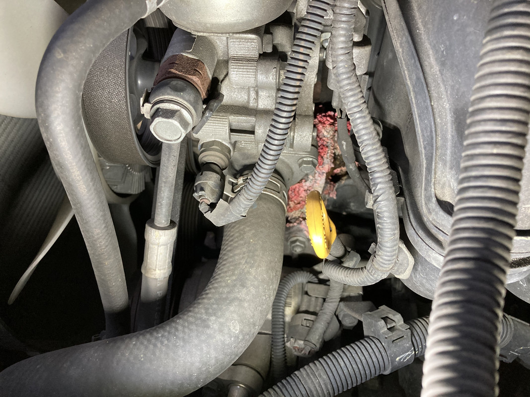

    2010 tacoma
    I have a very small coolant leak that is leaving the pink antifreeze mess in the pic. What is under all the gunk? Is this a common leak? I just want to prepare myself before a get into this further since my Tacoma is my daily driver. Any help is much appreciated, thanks.

    Yup... common on the first 2/3s of the second gens.

    When you get the metal replacement pipe MAKE SURE they give you the Gasket and not the O-ring Seal.

    get it done sooner rather than later too, if that bypass hose gives up on the highway you lose all coolant right away.

    Yes, definitely. It looks like it has been dripping for a while.
    OP, If you didn't pick up on the images the intake manifold has to be removed to access this pipe.
