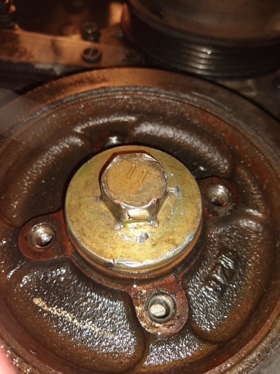

    Well tore into it today and found that the bolt seems to have come loose and wiggled out. The threads are stripped on the bolt, but I;m assuming this is from the crank spinning freely around it.
    Threaded it in without the pulley and the good threads on the bolt grabbed so I am assuming the crank is good to go. The bolt seems to be brass so I assume it wouldn't damage it too much. I'm gonna order a new bolt but now I am kind of confused because the one I see for the 3RZ 2.7L engine looks different than the one I have. It is possible it was changed since I bought the truck with 270k on it. Kind of resembles one off a 3.0 3VZ. I guess I will order one for the 3RZ unless someone tells me otherwise. Interesting either way...

    Good eye on the crank bolt not looking original. You know why that would've been removed previously? You know the repair/maintenance of the taco?
    Even then if those two pics from the website you linked are pics of OEM crankshaft pulley bolts, the oem one only has threads to about half the length of the bolt. Looks like the one you removed was different. I just wonder why it was opened up before, these 3RZs don't have a timing belt so that crank bolt was likely removed for something, before you got the truck

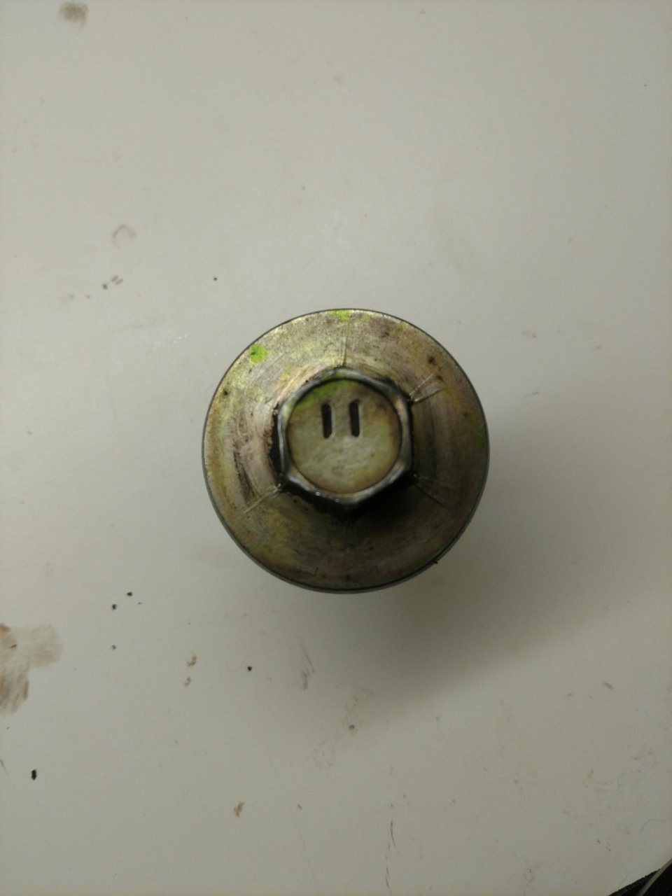

    Only theory I have is that it has come loose before and they opted for a bolt with more threads. I did find this guys post where he had the same bolt in a 2.7L. Has the same '11' on the head, but I cant find this exact bolt for sale anywhere online.
    cruiserguy[QUOTED] likes this.

    Never heard of one coming loose that hasn't been removed before. Doesn't mean it couldn't happen, just that I've never heard it. I'd run a new OEM bolt no problem. Are we certain the threads on the crank are fine? Don't wanna find out they buggered the threads in the crank and then railroaded some oversize bolt in.... Gosh I hope not. No way. No way someone would be that much of a monkey brain

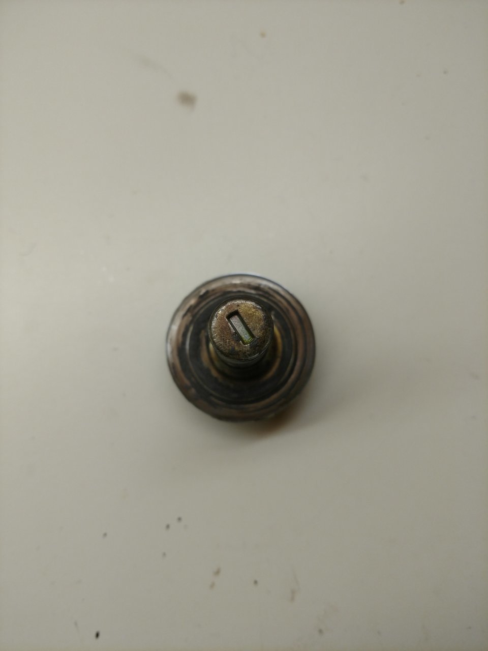

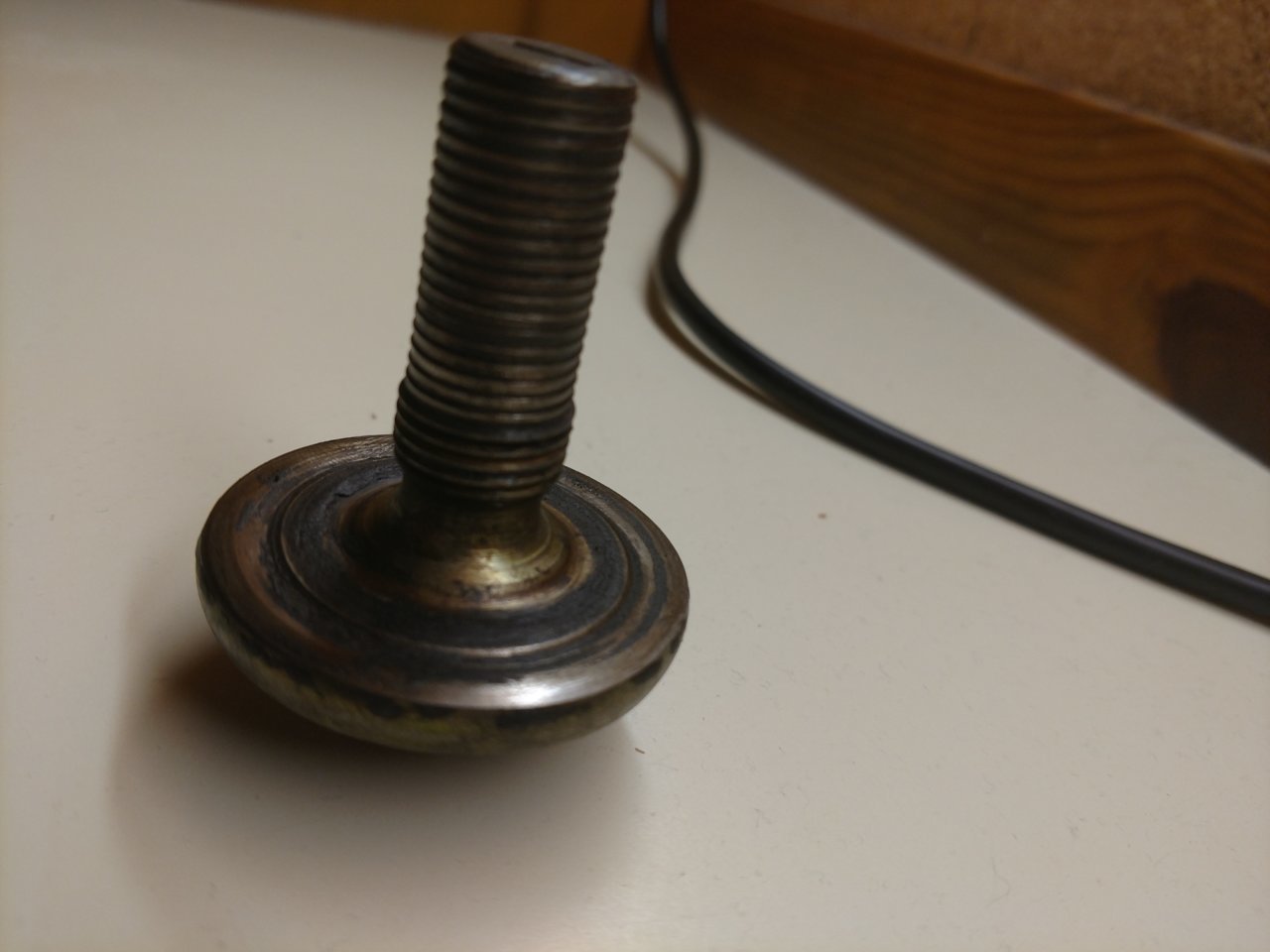

    I threaded as much as I could and seemed fine.I was confident it was a non-OEM bolt until I saw the same one in another thread and now I am second guessing if it really is or not. Any insight is welcome or a link to the correct bolt if you see that mine is wrong. Need to order this tomorrow morning and get the truck going soon.
    EDIT:
    More pictures of the bolt. It does appear to be pretty worn by the base of the bolt, but none of the threads are damaged near that area.

    This is the part number for the crank pulley bolt 90105-16041
