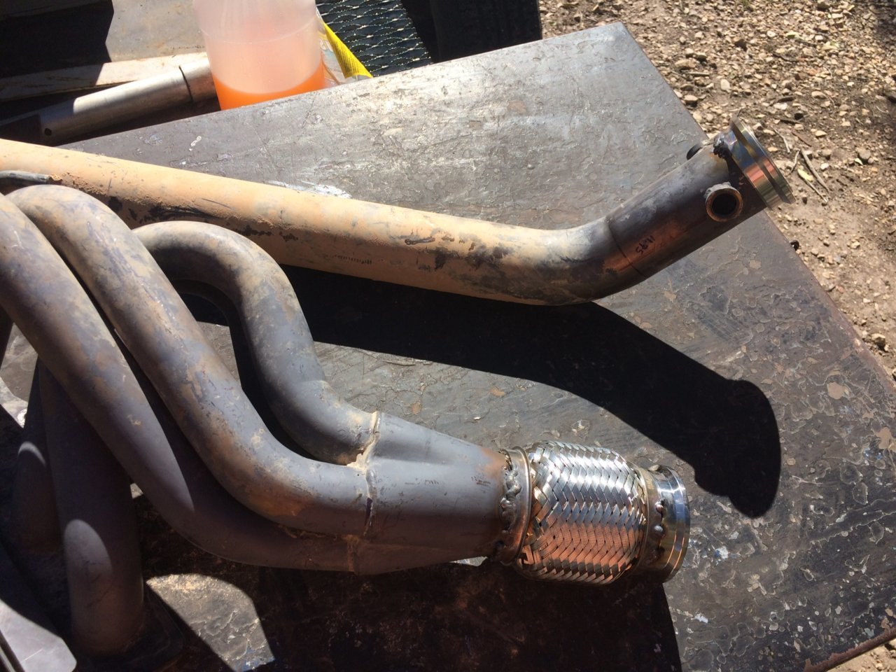

    Make sure you don’t have an exhaust leak between the header and the midpipe. I have had a similar issue with detonation under high load only and it was caused by a leak there since it is before the primary O2 sensor and that throws off the readings

    I went with a v-band because the stock donut gaskets suck. Worth the effort for sure. Also I can’t say for sure that it’s an exhaust leak, but I couldn’t hear mine yet it was enough to affect performance
