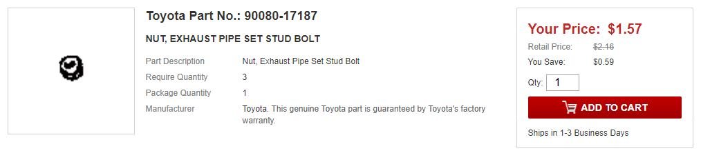

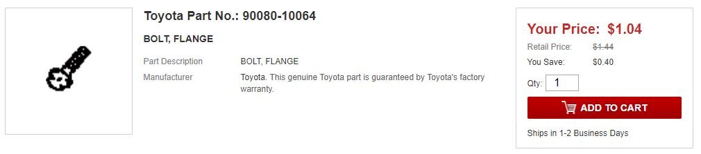

    I would check with the local Toyota dealer first

    If I had to guess size then 10 x 1.25 with 14mm heads
