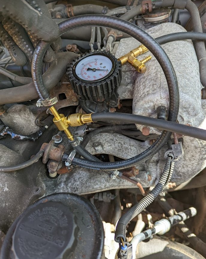

    Hi guys, I have an update
    I rented a fuel pressure gauge and plumbed it inline as shown in the picture. I'm only getting 5psi when the motor is running. On my jeep the same gauge reads about 50psi. I read the 2.7L should be 31-37psi when running.
    So I was thinking Fuel Pressure Regulator or Fuel pump is causing low pressure. I just replaced the FPR since that was easy. No change.
    Before I go for the fuel pump, I want to make sure I am getting an accurate reading with the gauge. I realized the fuel flows into the back of the fuel rail and then out the FPR, and I plumbed the gauge in AFTER the FPR. Could it be normal to have such low pressure on the exit side of the FPR??
    I realized the aftermarket gauge that LCE sells installs under the FPR so would not have this problem.
    https://www.lceperformance.com/Fuel-Pressure-Gauge-Kit-2RZ-3RZ-p/2019121.htm
    Hoping someone has experience with this... before I open the can of worms related to the fuel pump... Thanks!

    You need to be on the supply line to check fuel pressure, it looks like you are on the return line. You will see little to no pressure on the return line, I seriously doubt the engine would even run on 5 psi of fuel pressure.

    Thread couple years ago mech made the checker by gutting and old pressure reg so pump full pressure gets thru to that guage...
    I saved my old reg just to do that....one day.

    OK I had a feeling that was the case, thank you for confirming. I'm going to get the LCE pressure gauge then to be sure before moving on.
