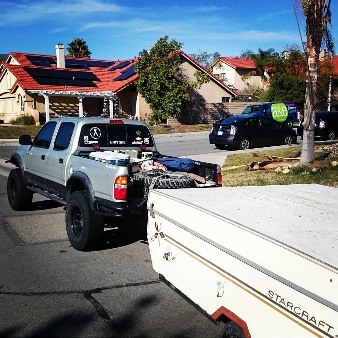

    I have a 2001, 2wd, 4 cyl. I tow my pop-up camper and single jet ski. Unless you're 4wd, I would avoid steep cement ramps when launching your boat. Cement may be slippery due to algae. Your truck will be a dog going up hill and having to slow down for people who get in front of you sucks too.
