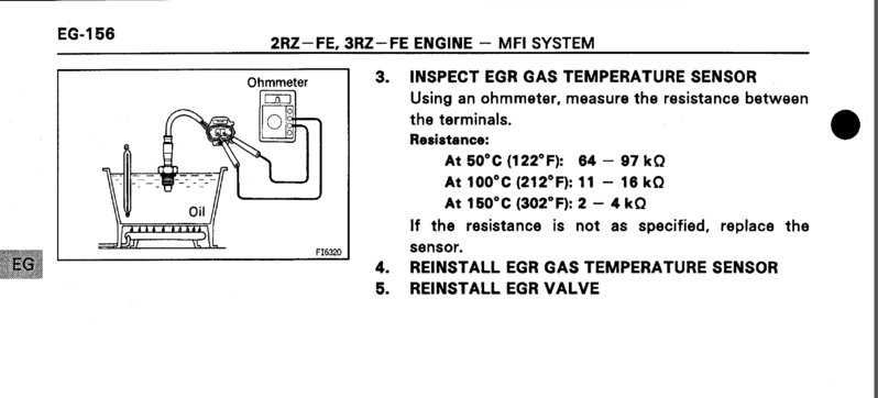

    So I was able to pull the EGR temperature sensor and clean it. I used a 14mm deep impact socket that I cut a slot in. This made it super quick and easy to remove.
    It had about 1/16" of hard oil/gunk/soot on it that needed to be scraped and scrubbed off. I then tested it up to 212*F by boiling the business end in water while reading the resistance across the 2 pins. I got 14k ohms which is within spec. I didn't have an easy way to get it up to 302* though.
    So I guess I am down to the VSV or the EGR Valve itself. I will try to pull the VSV this weekend and test it as well.

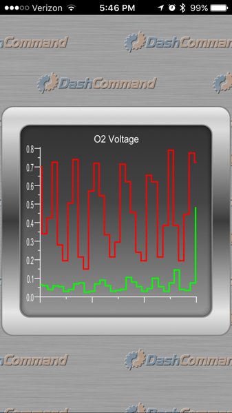

    Also, here is a current graph of my o2 readings. It is a lot different than before.

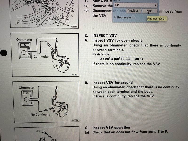

    I tested the EGR VSV today and read 38ohms across the terminals which is within spec. I did not have a chance to apply power to it to test its function though, I will see if I can pull it again tomorrow.

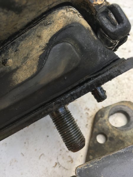

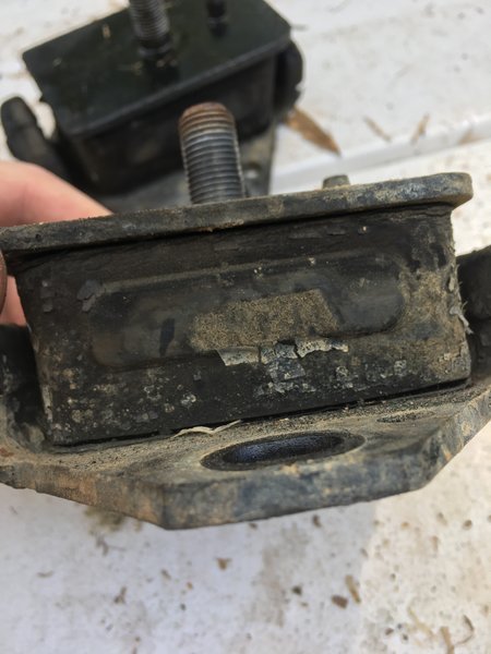

    I replaced the rear engine mount (transmission mount) today. The original one was definitely bad with the rubber separating from the metal. This, however, did not remedy the vibration/shaking at idle. It made it slightly better, but it is still excessive. It is definitely something engine related.
    I may pull the IAC again and see if I can diagnose it further.

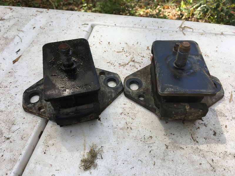

    Replaced both motor mounts today. They were definitely bad, but the vibration still persists!
    I may completely pull off the EGR to test it more easily, but I really don't know what else it could be. I think I have exhausted all possible issues.
