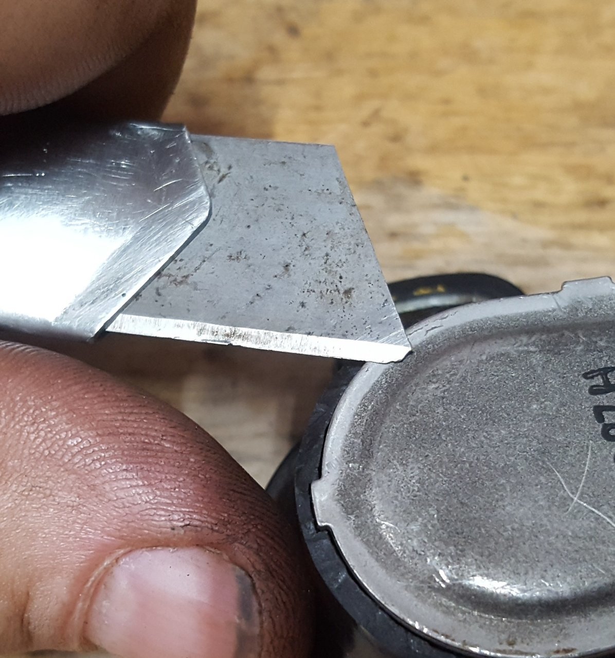

    First step, cut away the plastic holding the metal cover in place.
    Then, pry open the case. Be careful not to go too deep with the blade, as you will damage the water seal.

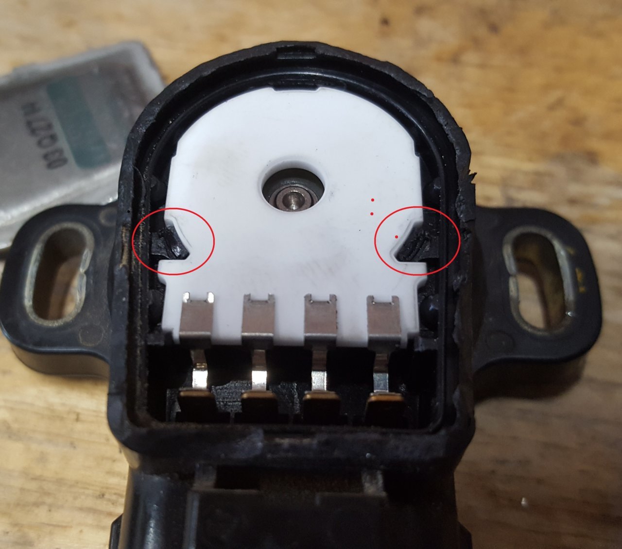

    After removing the cover, there are two plastic tabs you must cut.

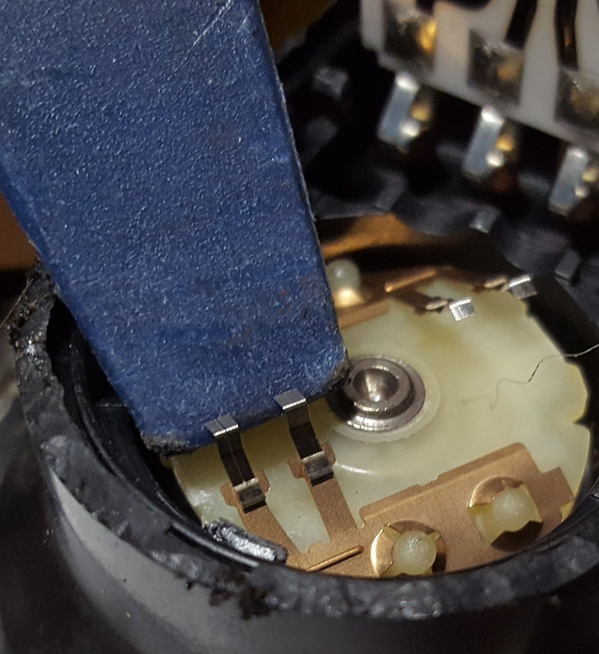

    Then, bend back the white circuit brd. The connectors are quite robust, so they will not be damaged.

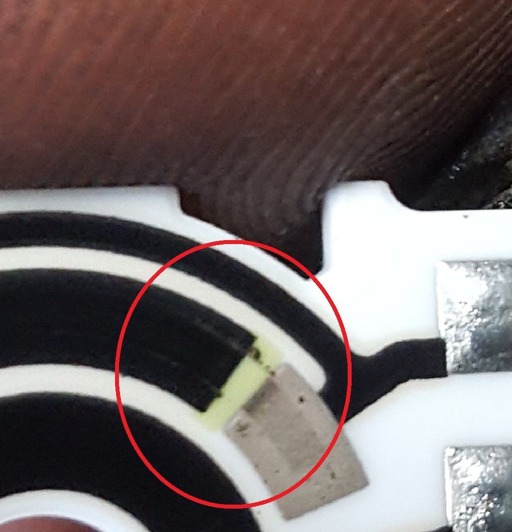

    On my sensor, there were contaminants which could have easily been removed from Contaminant Pic.jpg one of the circuits.
    There are several other possible problems which you may want to confirm if you try to repair and reuse one of these sensors.

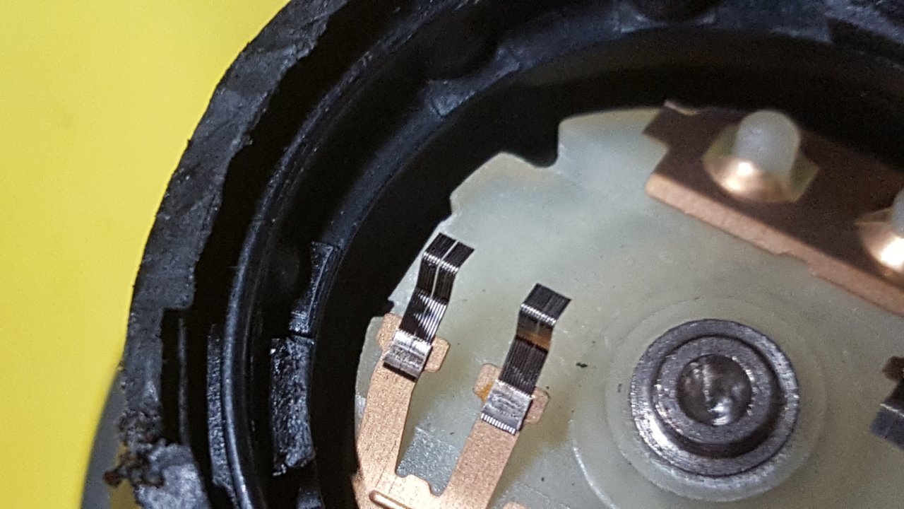

    Relaxation of the recoil pressure of the contact points against the circuit board. You can easily reshape them for increased contact pressure to the board.
    Cleaning these same contact points is another good idea while you have it apart..
