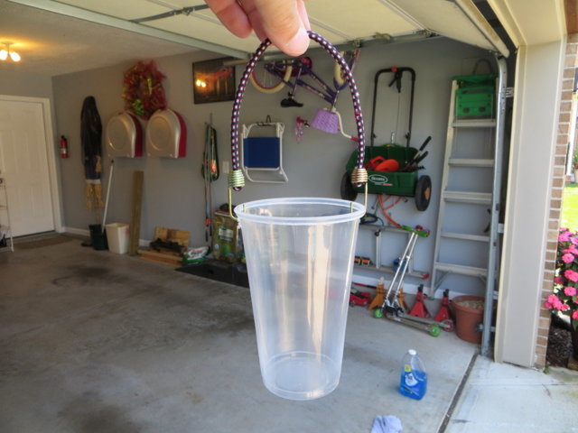

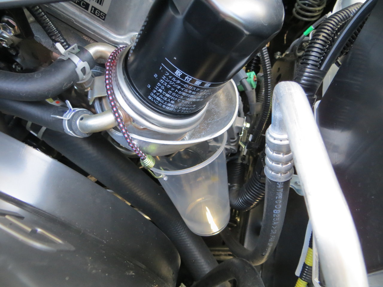

    My 1st 2 rigs were 2 .7s. I don’t recall them being too difficult. I always used a quart sized Zip Lock bag over the filter once it was loosened a bit to reduce the mess.
