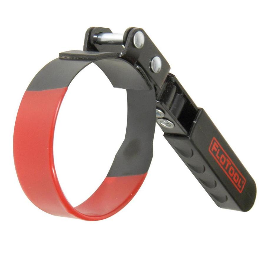

    It really is.........after laying down on the ground with a 12mm socket removing the middle splash pan, then lay down under the filter and position the 'ol style adjustable filter wrench where you can break it loose enough to turn by hand after you put a pan underneath it and let it dribble out it's little dab of oil that'll come out after loosening half way. When it stops dripping unscrew the filter by hand and dump the oil out of filter into pan sitting there. Once you get some finesse there won't even be any to wipe off the side of the block or edge of oil pan. Fill the new filter up to preload it so motor doesn't have to when you start it up and spin it back on and wipe off any drips. Then all you gotta do is get a 14mm on the pan drain plug, bust it loose and let it drain into the pan. Put the plug back in and tighten it up and fill it back up with 5 qts. The filter holds almost 1/2 qt if you let it soak in. This will put you right on full mark. Dealership can shove their "free" maintenance crap. You'll waste a lot more time and angst on that BS than it's worth. Get an oil pan with a spout on it and you dump the old oil right back into the 5qt jug that you just emptied and take it to auto parts to dump when convenient. Become your own maintenance monkey and not have to wonder if it was done right.

    Believe it or not this old school tech tool has room to get on Toyota's old school filter and break it loose. I use this type every time I change oil in my truck. It won't work on the 2018 RAV4 SE canister so I have a round cup one that goes on a ratchet for that.

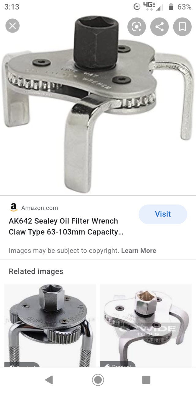

    The 2.7 oil filter location hasnt changed since the first ones rolled out in 1995. Ive tried all the tools, and this type plus a long extension is by far the best in my opinion.
    The cup style wrenches just slip off and cause me to cuss a lot, and there isnt a whole lot of room for the strap wrench or channel lock style.

    I actually bought one of those at AutoZombie the other day.. I think it was $9-10.00 ... (A shakey MIC thing..) ... I thought that if it didn't work for the one thing I want it to work for ... I might need it for something else in the future. So ... You can never have too many tools and all that, right? LOL!
    The thing that was 'WTF' for me was that ... The Toyota filter is your typical 14-flute filter ... But all the ones at 3 different stores were either just slightly too big, or slightly too small ... And I kept thinking that, 'C'mon now ... A cup-style filter wrench shouldn't be THAT hard to find/get...'
    A regular strap-wrench wouldn't be bad, but for some reason Toyota had to put some weird/big flange on the housing where the oil filter screws in. IDK what the purpose for that is, other than it makes things just that much more difficult.

    Agreed but just used what I had, there is room to get my band type on there and get it loose. Always only hand tight my filters.....except the cartridge one on RAV4.
