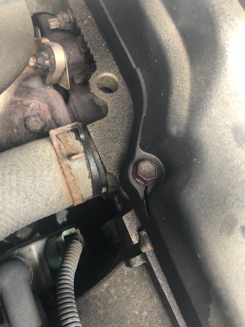

    Yep. Leaning that way. FWIW, it appears that the cover bolts have rusted badly and it appears their expansion is what cracked the cover at several of the bolt openings in the cover. Haven't been retorqued or futzed with ever, so I'm assuming that's what's going on.

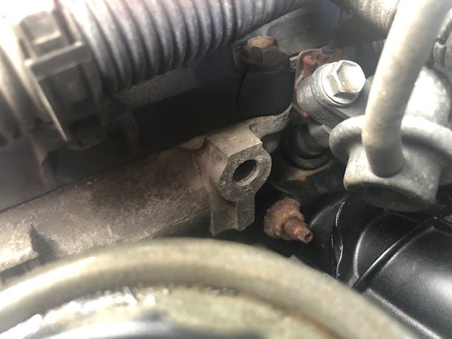

    Photos of three of the bolts showing cracks in the cover.

    I wouldn't bet on it; if that was my truck I'd buy a new cover. When the cover comes off, the ear in the first picture will probably also fall off. Even if it doesn't, there is no material left for that screw to clamp on.

    Go with the right amount of ugga duggas, too -- looks like someone tried to fix your leak with some extra ones, no bueno on plastic.

    The cover and bolts are untouched since the factory. My surmise is the bolt shafts rusted, expanded slightly and caused the cracks. If not, then it's just the time-aged disintegration of the plastic cover itself. But, ain't no ugga duggas on those bolts since the vehicle left the plant.
